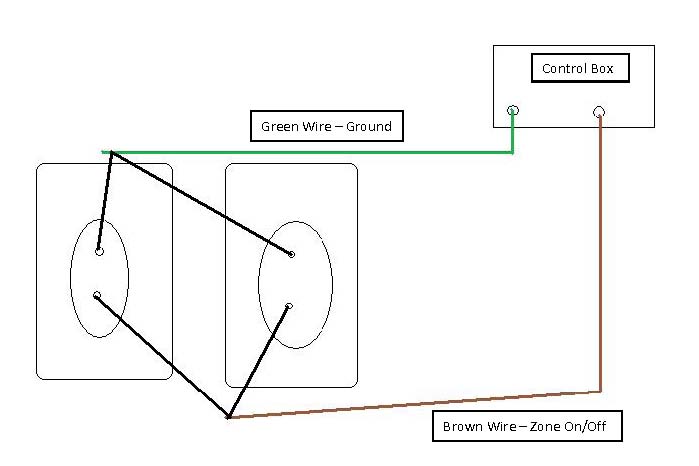

    I am having some problems with a sprinkler system. My system is a
    Nelson 8300 Jr. - Control Box with 6 Zones
    I have two valves for zone 1 in my system. One valve controls half of my heads and the other valve controls the other half of zone 1. I have the ground wire spliced/connected with the power wire from both valves, and the On/Off wire spliced/connected to the remaining wire from each valve. When they are connected this way the zone shuts off after about 2-3 minutes and the power short icon on the control box is on.
    If I seperate the two valves from the brown wire, and hook the brown wire to either one of the two valves by themselves, it works fine and runs the full time.
    I have attached a simple sketch of what I have.
    Any help would be appreciated and thanks in advance.

    I cut the wires back today to fresh pieces and wired them again. The run is about 40 - 50 feet or so maybe less. I have also tried the two seperate wires. I wired the brown to one value and a pink to the other and put them both on zone one at the control box and it still shorts out within 3 minutes. Should I seperate the ground into two wires as well, I can't really see the ground being the problem.

    Does the timer put out enough power for both valves?Each valve equals a one zone.You are operating two zones at once.You could also put in one valve to handle both zones and gpm usage.Then you would have one zone..Upper

    I don't know if you have a master valve or not, but if you do, your trying to operate too many valves at once. That controller , I believe, can only operate two valves at a time. The fact that it runs fine with only one valve connected to the terminal hints to this. Is this a brand new system that your wiring up or is this a new problem recently encountered in a previously running system?

    I think you are absolutly correct BRD. On Sunday, I remembered that I have a valve on the other side of the driveway in with other zones. So basically my zone 1 was trying to operate three valves and it could not do it. I tested this problem by hooking my zones 4, 5 & 6 together and it did the same thing as zone 1 was doing and shutdown within 3 minutes.
    So I had extra wires in the strand , so I hooked the two valves up seperaly as new zones 1 & 2, and combined/doubled up one of my small zones with zone 4. Everything is working great. Thanks everybody for all of your help.

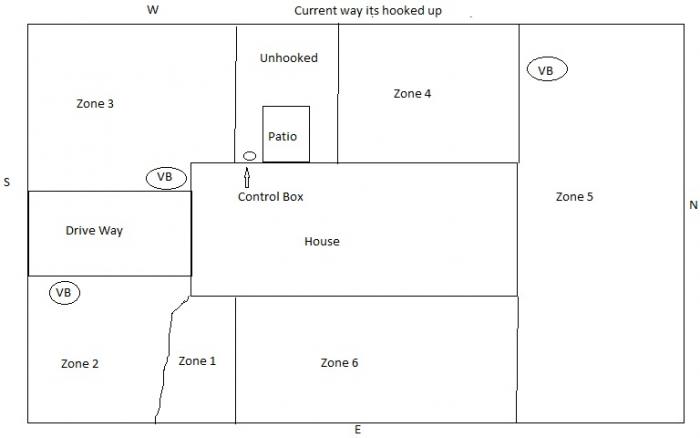

    Default Help with valves on my zones
    Hi Everyone,

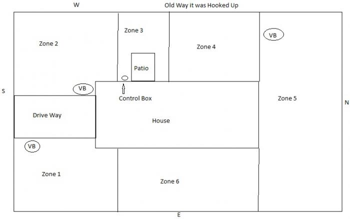

    If you have read all my previous posts from 2009, my problem was with one of my zones that was shorting out after about three minutes. This started after I fixed some leaks/valves and done some rewireing (unintentionally). Well the problem we determined was three valves on one zone. Likely a master valve on the west side of the drive and then two valves on the east side of the drive for zone one.
    To solve the shorting out problem, I used some of the spare wires and split the valves into two zones. (Zone 1 & 2). I was able to do this because I had one small zone around my patio that was a mound of weeds and unhooked it and moved the old zone 2 to zone 3 in my control box and created two zones out of zone one.
    Now the problem I have is around my patio, I removed the excess dirt and laid sod around the patio and now I want to be able to water the area around my patio. Well the problem is now, when I try to connect the wire for the zone around my patio to any of the 6 zones in my box it shorts out in 2-3 minutes or so. I have a Nelson 8300 Jr. - Control Box with 6 Zones.
    Is there a way to wire the two valves on the east side of my drive back together so that it will water as one zone and I can reclaim one of my zones for use at the patio area.
    I know it is possible somehow because when I bought my house in 2007 and started messing with the zones in 2009, the two valves in zone 1 worked as one zone.
    If anyone has any ideas I would be very appreciative. Like I said above, I think I have a master valve on the west side of the drive way, but I am not 100%. But I do know that I messed up the wiring in 2009 and was able to make it work for my needs in 2009. My control box has two sets/strands of wires coming out of it with 8 or so wireles in each strand. One strand goes to zones 1-3 and the second strand goes to zones 4-6 based on the drawing labeled below as the the old way.
    I have included some drawings of the layout of my zones and the yard. VB on the drawing is Valve box. The control box is located in the patio area.

    We know that the controller will handle two zones without a problem, but will your flow rate and pressure handle two zones on at the same time? Normally, with different turf/garden areas (watering conditions/plant needs/watering times), as well as pressure and flow rate restrictions, is why we install different zones. Your situation is also why I install a nine zone clock in a home that will be full with six zones - for any possible expansion. For another $40.00 or so it's way less expensive to put a bigger clock in to start with. But you also know that by now.
    If your pressure and flow rate will handle it - I would look at the combining the two smallest (flow rate and pressure use) zones as one zone. Maybe zone 1 and the unhooked zone as zone one. But I also don't know what is in each of those two zones because you will aslo have to consider that the two combined zones will also have the exact same watering times. Are they both turf?
    The only way to do it properly is to change to a nine zone clock. You have enough wire already laid.

    Hi Mick and hj,
    Mick on your question, I am mostly sure that that it can handle two zone on one, because it was hooked up that way when I bought my house and last year when I was messing with them I messed up the wires.
