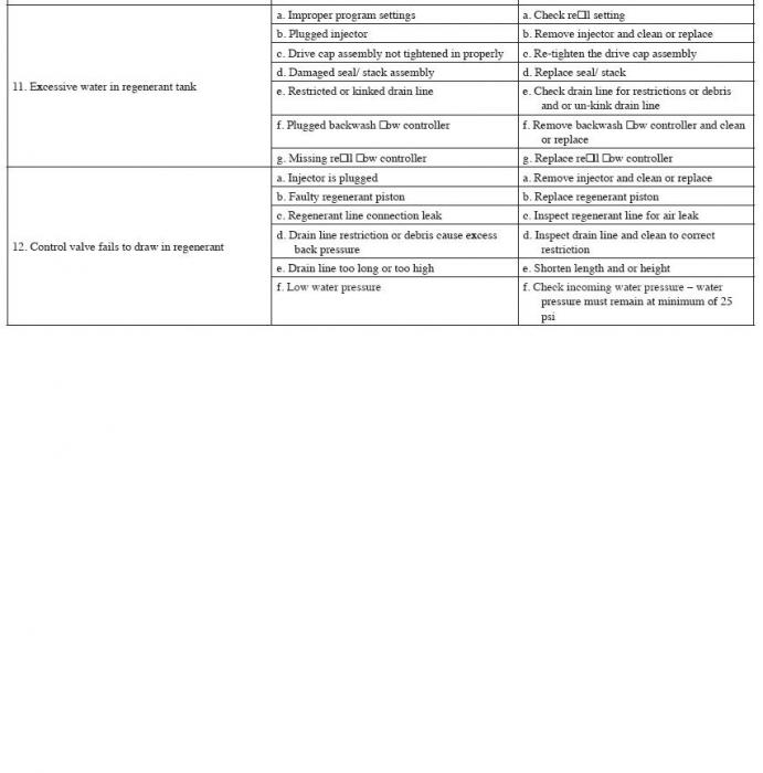

    Talking Question for gary
    got a clack water softener that is not
    useing salt....
    it wont pull salt brine from the brine tank
    and wont re-fill the tank either.....
    thought it might be a suction problem, but it still
    should refill the brine tank and overl flow the system..??
    correct??.
    it is doing niether.... and no kinked suction lines
    this Clack unit has been so trouble free with about 100 of them installed, that I have not have to yet really tear one down
    I suppose a clogged injector???
    do you have a troubelshooting spec sheet on these units that would run me through the diagnosis??
    6,361
    I've not had the problem of no brine refill; with 1220+. It could be a 2310 valve stuck closed.
    Otherwise a blocked injector and/or its screen or, a kinked drain line or blockage to/from the brine piston. Blocked DLFC in drain line elbow bottom.
    Hell man, you ought to get a valve and tear it apart. I have had a couple women do it and I'm sure they're shorter than you are!
    If it isn't the 2310 valve stuck up/closed. Shut off the water to the softener, open a faucet somewhere to relieve pressure, by pass it, holding a rag around the area, unscrew the injector area nut, you'll get a few tablespoons of water, clean the injector and screen and put it back together, put it in Service and turn the water on. Test fill and suction. It will take you maybe 8 minutes. Next time 3 minutes max.
