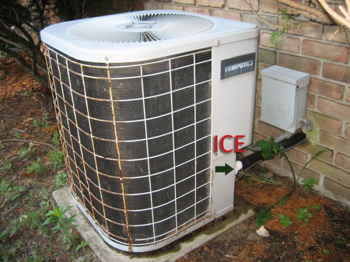

    Greetings all,
    We recently turned back on the Central AC Unit and we noticed that it isn't blowing very cool through the vents and then, after a while, it isn't blowing cold air pretty much at all

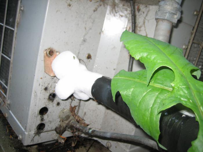

    So we went outside to look at the unit and we noticed that the connector is iced up!
    I've attached an image below--does this look like some kind of common culprit? And, if so, what needs to be done to fix it and about how much is that going to run us?
    Thanks in advnace for any help you can give us!

    You likely have a leak in your refrigerant or you were running the system on a super cool night.
    Matt
    Enjoying life in SW Florida
    9,004
    This is generally not DIY. There are a million things...some real bad, some not so bad.
    Could be as simple as a clogged filter drier, dirty evap and/or condenser coils, needs a charge, etc.
    Time to get a well qualified HVAC tech to take a look. He will get his gauges on the high and low sides, calculate the super heat, check the delta T across the drier, evaluate the coils and clean as necessary, etc.

    It's probably low on freon and needs cleaning.
    The quickest way to get some cool air is to set the fan to continuous and then set the thermostat up until the unit cycles on and off.
    This will give you a little bit of cool air, however it won't be as efficient.

    The first thing you will have to do is let the evaporator (inside unit) thaw out which will take a little while for the ice to melt.
    Check for a clogged filter.
    Check for a dirty coil especially if you have ever run your unit with out a filter. You will have to clean the coil
    Check to see if you blower (evaporator) fan is operating....blowing air
    See if you can see where the ice stops it the coil is not icing up. Where it stops is probably the bad component....expansion valve if you have one...or filter dryer...etc.
    If none of the above you may have a leak as mentioned previously of which you will have to get a mechanic to check the pressures and find the leak.
