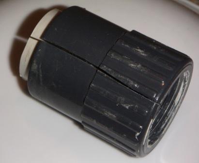

Stay away from PVC female adapters..
PVC female anything has to be installed carefully. I've had a 1" Fleck yoke adapter crack, and a 1x1x1/2"F Tee crack -- both plastic-into-plastic connections. Both were "professionally" installed by a guy with an 18" pipe wrench and no fear of using it, while bragging that his fittings never leaked. (In all fairness, they didn't leak -- until they failed.)
I use a combination of Teflon tape, a wicked blue dope I've mentioned in other threads (Hercules BLOCK), and moderate torque when tightening. So far so good.
Yeah 3-4 wraps of Teflon tape and hand tight plus a turn or so with a wrench or pliers and stop. I've never had a leak or any break. And to make sch 80 PVC break takes a lot of effort.
