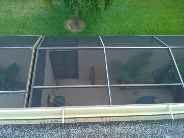

Well, in my case, the only risk of falling comes from the ladder. The roof itself is a flat concrete deck w/tarred gravel. :)
The main thing stopping me from doing it myself is the need for an outrageously expensive 30+ foot extension ladder. The roof itself isn't that high, but there's no direct route TO it. The back yard is walled in and topped with a pool-type screen enclosure. The front has pergolas blocking every straightforward route to the roof -- my own OR the neighbors. I can't climb up to the neighbors' corners from my own front yard, because there are pergolas in the way on both sides that extend out as far as the front wall of the neighbors' homes. The DirecTV guy had to route the extension ladder at almost a 45-degree angle to clear the pergola over the front door (the bottom of the ladder was almost in the bushes with red flowers you see at the front right).
I wish the extension-A-frame hybrid ladders could lock at a position somewhere between 130 and 160 degrees (instead of 180). THEN I could get by with a relatively affordable 22-foot ladder by making the ladder relatively steep between the ground and first bend somewhere above the pergola's height, then make the second half a little shallower (basically, folding the ladder around the pergola). Unfortunately, the Werner 22' ladder I saw at Lowes can only lock into 3 positions: closed, A-frame, and 180 degrees.

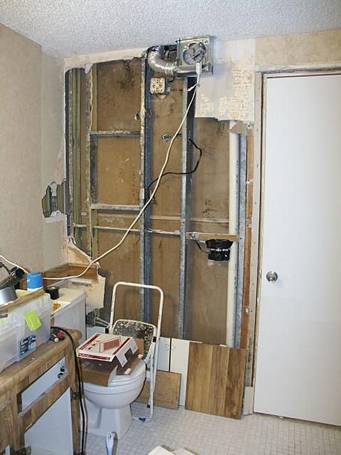

For reference, here's a pic of the wall as of last night with the fan (temporary... my real one's a Panasonic & won't be here until next week) temporarily rigged up to suck out the drywall dust. As you can see, the rear of the wall on the other side has been completely trashed by water coming from somewhere. Interestingly, the drywall I removed (on the bathroom side) was nowhere near as bad as the drywall you see in this pic. It had some mold, but didn't have much outright water damage, and the mold itself was mostly scattered patches instead of "rolling fields".

Unless the installation instructions specifically say the use of PVC is okay for the duct, it's not a good idea...use a solid metal duct. If you screw it together at the joints and seal it with the metalized duct tape (not fabric duct tape!), it should not leak.
Some of the Panasonic fans require a 4" duct. Note, you could convert to a rectangular duct in the wall to make things fit, convert back to round, if needed, higher up.
Depending on whether the roof is a membrane, or what would determine how to connect and seal the penetration. If a membrane, you need another piece to patch, the special contact cement, and then caulk the seam. You probably will want a boot designed for that penetration. Because access is not easy, you want this done right the first time.
Flat roofs are much less tolerant of poor installations. A sloped roof has water flowing over it...a flat roof can have standing water, so the requirements to seal things are quite different.

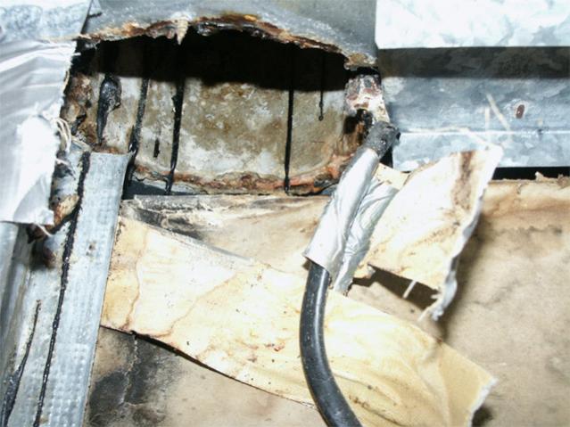

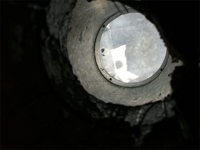

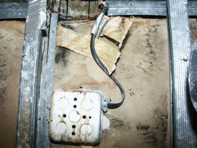

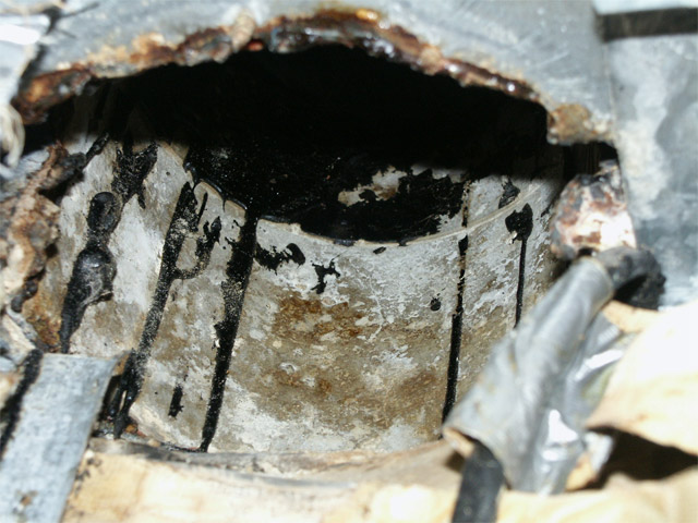

OK, I'm home from work now, got to see the vent for the first time in daylight, and took some pics.
I'm not really sure whether it's good or bad news, but there DOES seem to be flashing and a cap... but from the pics, I think it's pretty obvious that it's leaking like a sieve, and has been for quite a while.
I also made a happy discovery... it looks like a 24' extension ladder *just* might be long enough to reach the roof. From parapet wall to ground, along an angle with the ladder resting on one of the pergola beams (a beam I might very well remove tomorrow if necessary to save a hundred bucks on a ladder), it's a hair under 22 feet. Sadly, a hair too long for a Werner MT-22 MultiLadder to likely work, but should be OK with 24'. Not quite kosher, but not much more dangerous than a 26' or 28' ladder would be, anyway.
After seeing it clearly with bright light from above, the relationship of the vent pipe to the duct became readily apparent: it's just inside it, attached to nothing. I pulled it down & out to get the pics of the shaft, then put it back up like it was before. Kind of a bummer, though... if I'd known the shaft were so wide, I would have considered trying to somehow build a raised area to accommodate a fan with 4" or larger duct.
Pics, from top to bottom:
#1: View of the duct area. The electrical box is for the vanity light in the dressing area on the other side of the wall... looking at the condition of the drywall with a flashlight, I'm sure I'm going to be tearing out and replacing the drywall over there, too.
#2: looking up towards the shaft
#3: looking a little higher up into the shaft
#4: looking at what's presumably the flashing and vent cap on the roof. It actually doesn't look bad from down here, but for all I know it might have a gaping void. I tried looking up the shaft with my wall inspection camera (basically, a webcam with 2 white LEDs on a 3' gooseneck rod with wireless LCD display), but the camera on it is crap (think: late-90s webcam) and has no dynamic range or focal depth to speak of... the sunlight near the top just completely overwhelmed it, and all I could see was white (the pics below, including the last one, were taken with a DSLR with zoom lens).

4) The fan vent's flashing is the least of my problems. I need roofers.
Basically, what I found are a few big (3+ inches high) mushy blisters. The roof's surface is basically tarred-over paper. Ugly, but the roofs aren't visible from the ground anyway, so it's OK. They look kind of like what tile roofs look like before the actual tile goes on.
My new theory is that water is getting under the tarred paper, then flowing UNDER the flashing into the nearest hole. One thing I noticed was that the vents and a/c power condiut on one neighbor's roof looked like artificial islands with sea walls... surrounded by some kind of solid retainng structure, and built up ~6-10" above the surrounding roof. The other neighbors didn't, but I noticed something else... that same neighbor's roof was almost completely dry. My roof was almost completely submerged under at least an inch or two of water everywhere, as were most of the other neighbors' roofs. I think I'm going to ask him who his roofer was...

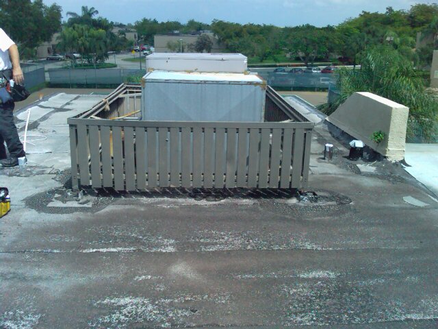

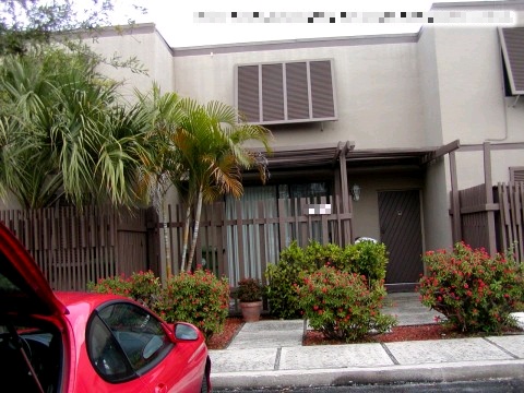

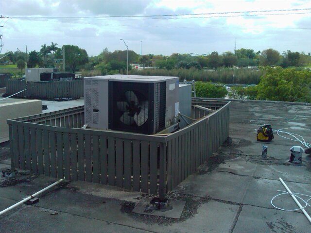

Update! Found some pics of the roof I took last year when I took advantage of the DirecTV installer's ladder to get up on the roof for the first time. The vent you see to the right of the air conditioner in the middle pic is the one where the water leakage was observed. It's not too visible in the pic, but the blister I suspect is responsible is approximately centered along the seam between two sheets of tar paper that's one sheet closer to where I was standing than the vent stack itself (the tip of the white pipe at the lower right that's pointing at the yellow tool bag lies a few inches away from the seam I'm talking about). The third pics shows why my roof is inaccessible via ladder from the rear.
For what it's worth, the pic perfectly illustrates the real-world benefits of a concrete roof in Florida. This is a roof that looks like hell and has been through a hurricane (Wilma) that destroyed wood-framed houses built nearby & left just about every wood roof in Broward County with major damage... yet, despite having not been repaired since then, or having had any significant maintenance in a decade, didn't even leak badly enough to discolor the painted surface of the drywall's "room" side. As bad as the wall looks in the pic a few postings back, you'd never know anything is amiss if you look at the other side of that wall. I was actually pretty shocked to see what the wall's rear side looked like.

What you have there is not a flat roof. The tarpaper you think you see is what appears to me to be a torchdown roof. You could get that replaced for much less than $8,000. You could save even more money if you tear it off yourself.
