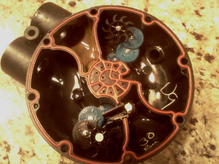

    Yes resin can get up in the head when the tank is laid down flat, or dropped. So you probably have resin in the head causing a blockage of something.
    Resin cannot get up into the valve if laid down on it side. Those who understand how a Kinetico works wouldn't make this statement. It is like saying if you change the number of people using water, you would have to change the metering disc.

    The check balls are located between the level 5 and the main base. There are 2 towers in the main base that the check balls sit on. On the level 5, it houses the check ball seals. In later models, the check balls were replace with what looks to as a very small lawn dart.
    Actually the yellow pins were an earlier feature. All Kineticos needing a brine draw will use the check balls.
  3. #63
    Loose plastic parts in a Kinetico valve is a bad thing and would mean you need a new whatever it is.
    Needing a new "whatever it is" is inconclusive. Still waiting for it to be identified.

    Quote Originally Posted by dano1001 View Post
    completely tore apart the control head, found two pieces of debris, one plastic chunk partially blocking an orifice, and one chunk of scale like material. I am not very confident that this caused anything. I slapped it back together , leak checked good, and I will test the water tomorrow. Maybe I have the plumbing routed wrong (black pvc tubung), I dont know. I will look at the float assy and hoses next. I have more pictures of everything I tore apart if anyone is interestedAttachment 14908
    Attachment 14908
    This is NOT a Kinetico water softener control valve Level 1. This must have been taken from another unit and adapted if used as a softener. So it looks like it had been previously taken apart and reassembled. I wonder what other parts are missing or out of place. I would say it is a filter unit and not a softener, therefor.....tah-da! No balls.

    Quote Originally Posted by water solutions View Post
    Andy, I went on a service call last year and the customer had what I referred to as a newer model Kinetico (the bolts holding the valve together were recessed into the level 1). That's when I found the dart looking seals which was on a softener. Is it possible Kinetico changed to the pins instead of the check balls? That's what I assumed when I saw them. I don't get a chance to work on Kineticos very often so that is why I said about the "darts".

    Sorry, I stand corrected. The check stems are in the newer MACH valves and various older models. These cannot be altered with check balls because the receptor ports are shaped different. I don't know when Kinetico made the switch but I can image out why. Thanks. I like these stems more because they stay in place better when working on the valve.
    Have you even taken apart the cap assembly with the pawls and discs?
    No. I only went into the body. I liked what I saw. Had to clean the venturi and drain flow control of debris (would not draw brine). Thanks for vast knowledge of the Kinetico valve and water treatment in general. It is always nice to have a proper debate with someone who will listen to others and "if" wrong, admit it. Thanks.
