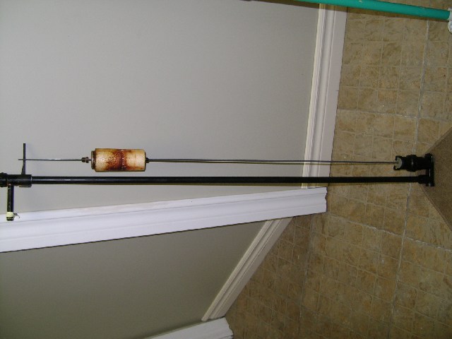

I accidentally snapped the drain barb off the softener one day while working in the pump room and lucky for me I had a spare plate in the box of parts I found so I took apart the valve, cleaned it all up and replaced the plate with the broken drain barb. I then reassembled it all, put it back into service and never thought about it again. That was back in November.
About a month ago we started noticing that the water was getting hard and we started to get large rust deposits on the tub and sinks etc. I determined that the softener is no longer regenerating/drinking in the brine even when manually turning the control dial.
Here is what I have done so far based on other posts I have found here;
1) Disassembled and cleaned out the brine pick up tube.
2) I left the pickup tube off and manually cycled the dial to see if I had any suction on the hose, no joy, just water pouring out continually. The flow did slow during the "brine-rinse" cycle but it would certainly not pick up any water.
3) I have now disassembled the valve again and made sure everything is clean and moving freely. I blew out all the orifices and the venturi with compressed air.
4) Disassembled and cleaned the gear housing and screen and closely inspected the pawls and gears, all looked good to me.

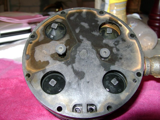

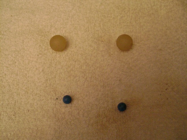

I then decided to have a good look through the box of parts and low and behold I found 4 plastic balls, 2 small blue ones and 2 bigger white ones (see pics) that I did not have in my newly reassembled valve?? :confused:
Does anyone know if these balls are part of this valve? Does anyone have an exploded view or diagram for this thing?
In the pictures the valves are in the same position that they where in when I disassembled it, do they look like they are in the right positions? Anything else I should do while I have it apart?

Balls are check valves.
I have looked for years for a parts breakdown and have never found one. No one has said they found one either. It's part of Kinetico's way of protecting their dealers from DIYers.
If you had soft water for months and then it went hard, I wouldn't think there was missing parts.

The check balls are located in the main base. I have had them fall out of place while reassembling the head.
Thanks a million! :D
I found the 2 pillars the blue balls sit on in the base but what about the 2 larger white balls, do you know where they belong?
One of the blue balls was floating on the top of the tower and the other one is missing?? Should I try and flush it out of the towers or just not worry about it?

Also, the rust in the window is likely because the tanks have not regenerated since I "fixed it" back in November. :eek:
I am pretty sure I misaligned one of the blue balls when I assembled it back then...
I took apart the pickup tube and it looks pretty straightforward, there appears to be a floating ball type check in the bottom and a small rubber cylinder with a hole through it at the top above a screen? I cleaned the screen and check ball assembly... Is it worthwhile updating to the newer style? What is the advantage?

:D Back in action! :D
Thanks for your help guys!
I had a nice soft water shower this morning reminding me of what I had been missing...
I guess the white balls where from a different machine.
