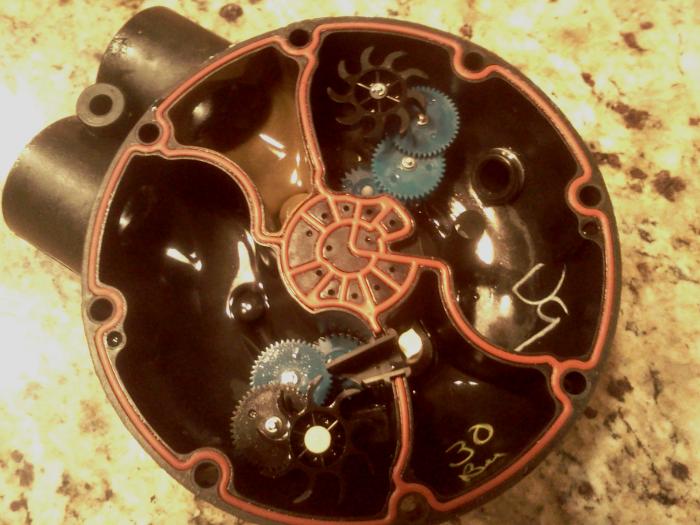

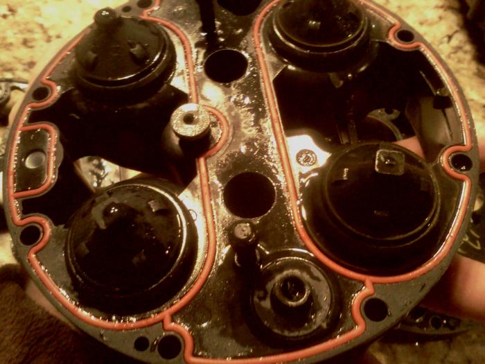

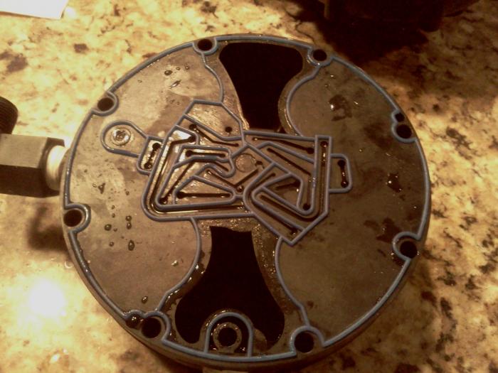

    completely tore apart the control head, found two pieces of debris, one plastic chunk partially blocking an orifice, and one chunk of scale like material. I am not very confident that this caused anything. I slapped it back together , leak checked good, and I will test the water tomorrow. Maybe I have the plumbing routed wrong (black pvc tubung), I dont know. I will look at the float assy and hoses next. I have more pictures of everything I tore apart if anyone is interestedName:  IMG_20111222_200858.jpg

    Loose plastic parts in a Kinetico valve is a bad thing and would mean you need a new whatever it is.
  13. #58
    More pictures would be nice, The 'plastic' piece, was it a foreign piece or something that came apart in the valve, which would be quite rare. Could you take a picture of that, too? Outside of the seals, there are only three small pieces that come apart when disassembling it.
    Resin beads cannot get into the head of that unit even if it was operating upside down. Something like the riser tube would have to be broken for that to happen. Understanding the equipment helps in troubling shooting.
