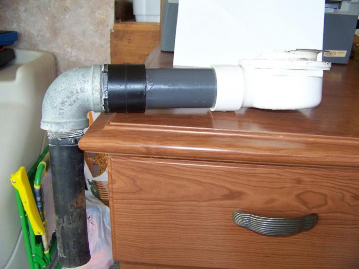

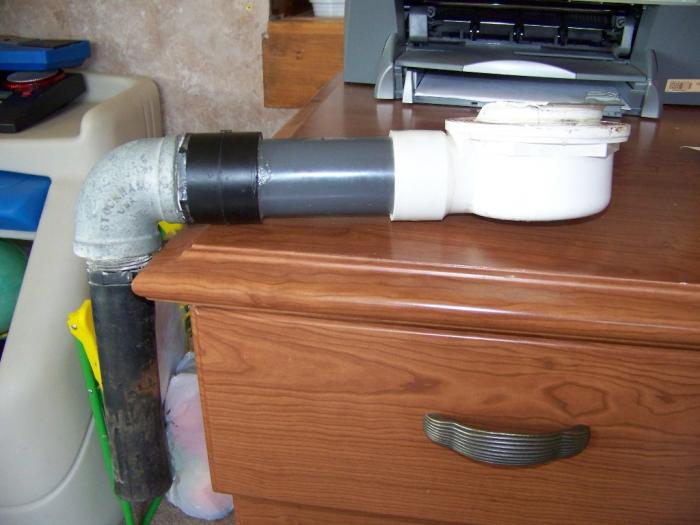

    I am trying to locate a shower drain fitting but having no luck. Been to all the local stores and have done an exhaustive search online with no results. It is the weekend so I can't call a plumbing supply house for help, thought I would try here.
    I have a shower setup that isn't the normal way so I have to improvise. For whatever reason when they built this house 40 years ago they put the shower drain about 2 1/2 feet from the commode. I removed a cheap square 32" shower stall that sat on a raised tray and the drain was plumbed over to the cast iron pipe in the concrete. This is in a basement. I am putting in a corner shower stall but the drain isn't anywhere near the shower base drain opening. I am using a masonry blade in my circular saw and air chisel with my compressor to make a trench in the concrete to lower the plumbing down enough to fit under the new shower base.

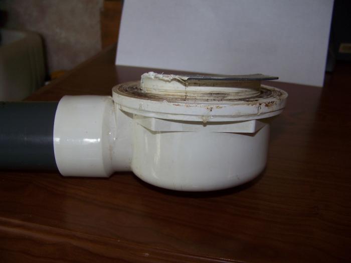

    I am trying to replace this fitting because I tore it up removing the old shower stall. The fitting has a 2" threaded opening that attached to the shower drain and a horizontally located 1 1/2" non threaded opening for pvc pipe. On the bottom of the fitting it says, "PVC-DWV NO.82.305 WHITE US Patent NO. 3895398. I searched on google with these numbers with no luck as well.
    If anyone has any idea what this thing is called or where I could get one please let me know. Pictures provided below...

    Where are you located? The reason I ask is because that would never meet code and the PVC looks like irrigation pipe. There needs to be a 2" PVC line sloped 1/4" per foot to the main line with a 2" p-trap and riser directly underneath the drain of the shower. Since you're already planning on trenching the concrete slab, there is no need to find that fitting again and you can bring this new shower's drain line up to code now.

    They used a tub shoe:
    It is typically used as part of the waste and overflow for a bath tub:

    It doesn't look that much like whats in your pictures. Are you sure.

    The tub shoe would be 1 1/2" and you said 2" so it is one weird fitting.

    Your setup appears to not have any trap, which is not only against code, is a very bad idea for both health and your nose. Neither does it have a vent. The fact that it drained is not the issue. Since it goes a ways, then drops down, it appears you have enough depth to do this right.
    Nov 2005
    2,152
    The P trap is farther away, downstream, and yes this is legal and it has been discussed in recent threads here. We cold ask the original poster whether there was much or any gunk in the pipe.
    The fitting in question performs that same function as a "tight elbow" under an ADA lav. or as already mentioned, a tub shoe. Search on tight elbow. Geniescience
    This is not a lav, it's a shower.
    Shower should have 2" p-traps, not that tiny little section of pipe and pressure 90's that he's showing. The whole thing is a mess,

    naw, I located a plumbing supply house that has the same fitting and I'm going to do it my way. build a base and have it slope over and run into the same pipe thats there now.
