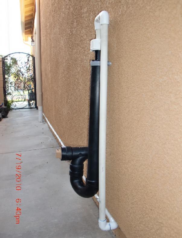

    Default Softener drain line question
    Hi I guess this is more of plumbing question than water softener question....
    I'm trying to plumb the drain line for water softener, I have seen houses in my neighborhood doing the way like in the picture:
    So I assume this is up to my local code (CA), I have some questions:
    1. I don't see its vented, is it OK?
    2. Will it be OK if I reduce the p trap to like 1 1/2" and reduce the height to 1/3 so it doesn't look as bulky?
    3. Any other concern of using cleanout this way?
    Thanks for your help!
    Jan 2012
    1,707
    California plmbing code requires a true break between the softener drain and the sewer pipe. It must be no less than 1", or twice the diameter of the drain pipe. Check out this link for some great information. http://airgap.com/
    It looks like your installer did that fairly well. In regards to the height of the standpipe, we have some great plumbers with extensive knowledge on this forum, I am sure one of them will have an answer for the height and diameter issue.
