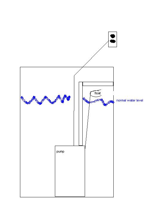

    The pump is intended to keep the water level below the top of the footers. You can put a block in the bottom of the pit if it is sized to maintain the water level below the top of the footer. You can alternatively get an adjustable switch to control the water level better than the factory one might.
    Don't unplug it- as soon as you leave it could pour down rain and you will end up with a flooded basement.
    More often than not this type of problem can be corrected by extending downspouts and properly grading the soil around the home so that surface water flows away from the foundation.
    Also, if the sump pump isn't pumping the water a fair distance away from the foundation, it will be likely to make it's way back to the pit, only to be recirculated again and again.
    I was asking about leaving it submerged is because I was considering moving the float to above the pump. I'd like to know if I can leave the pump submerged and only pump out the top 1 foot of water in the pit.
    I've attached what I'm trying to do. I want to leave the pump submerged all the time and just worry about the overflow. During the dry season, the water line goes above the pump and we can just unplug the pump and we're fine.
    Also the water pumps out into the street, slightly more downhill than the basement.
    Maybe I'm just really confused.

    A cast iron pump should run occassionally or it will corrode and freeze the impeller.
