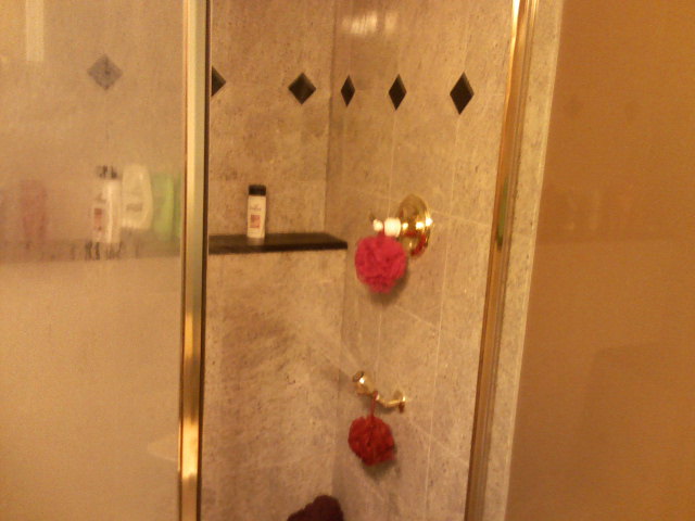

    Like this picture? Found this in Elgin in a house that was only 2 years old.
    Good one
    Not exactly the "application" I had in mind. haha

    I couldnt get the other shower head in the picture. Both are there. And yes you can do it. Any plumber can set you up the way you want it.
