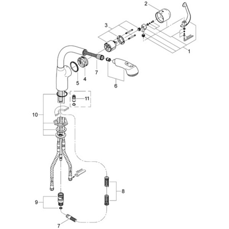

The GROHE LADYLUX PLUS faucet is 6 years old. The hot water side is leaking and won't shut off, I shut off the hot water valve. The cold water side works fine,. Can you tell me the part and how to fix the faucet.
Thanks, Ted

The part number is 46 048 000.
Turn of the water first.
There is a screw at the bottom of the handle you need an Allan key to remove it, once that is off there is the handle hub which will slide off, under that is the cartridge which is held in place by two screws, once they are remove the cartridge will pull out and then you repeat the process backwards to install the new one.
