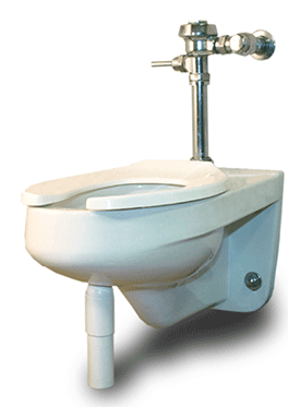

Hi everyone.
I am thinking about wall-mounted toilets and their wall brace's capacity of only about 300 lbs or so (at least that is what the experts say). I have been able to find some news articles about lawsuits and stories for broken toilets, but not that many as I'm sure a lot of there things are settled. I am trying to figure out just how big of an issue this is.
So I guess my question is: do you think broken/loose wall-mounted toilets are a problem in this country (USA), or are they becoming a problem?
I've been getting mixed signals when talking to people in-person, some say very much so and some say they've never heard of any issues. Thanks in advance for your thoughts!

Installed hundreds around here.
Have only had a service call for one...we did not install.
I would consider any given number like your 300# is given with a fudge factor built in by the engineer.
If you have carriers to install I would bid them to th 500lb carriers if there is doubt in your mind.
Bottom line, not an issue.

There are several different types of carriers. Cast iron ones imbedded or anchored to the floor, and stamped metal ones bolted to the wall structure. The weight limitation is usually determined by HOW it is anchored rather than its construction. One bolted to 12' tall 2x6's would flex more than one bolted to a concrete slab, BUT that would also mean the entire wall was flexing. 300# would be a very low limit for a carrier or its toilet.

well I’m close to 400 pounds and recently sat on my first wall mounted toilet and... it broke of the wall which was quite startling, I’m just glad I caught myself on the way down. I would think twice about a wall mounted toilet unless your sure no overweight people will sit on it.

The ONLY way it could "break off the wall" is if you DESTROYED it. The carrier in the wall would not break, nor would the attachment bolts, unless the toilet itself cracked in MAY places.
The wall structure needs to be up to snuff. If it's wooden, over time, the wood may have dried out some and that can work things loose, but normally, the wood isn't all that wet to start with. The metal carrier can hold significant weight IF the wall is properly built.
IF the wall is tiled, I doubt they'd go to the trouble to open it up and tighten thing up or add more strength. It's generally not the carrier, it's how it is attached. Porcelain doesn't really perceptably flex, and if overloaded, would break before it flexed. The carrier, too, won't flex under that load, but can move if the wall does, or the bolts are loose.
