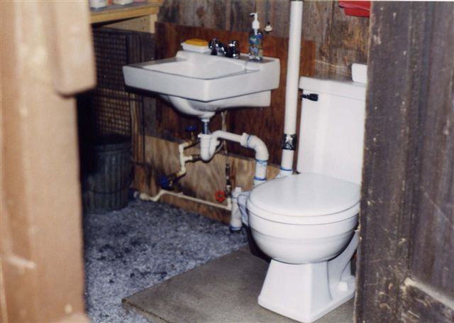

    Yes, the Mansfield was very easy to rebuild.
    The photo below is of the matching Mansfield sink and toilet that I installed in the attached shed at my camp in the woods. I rebuilt the tank using authentic Mansfield parts, new lever, 09 Ballcock, and 210 Flush Valve. The toilet worked flawlessly with my gravity water system (15 lbs pressure) and did not plug.
    I wish I had kept this one, but my friends in the neighboring camp needed it more than I did because they required an exact match for the base to clear a trap door in the floor in front of their toilet. Before I gave it to them, I swapped the 09 for a Fluidmaster 400A, as that is what they were familiar with.
    Almost 5 years later in what is now a year round home, my Mansfield is still working flawlessly!!
    Here is a photo of it in place in the shed (my test center for my restorations).

    Looks like I pressed the wrong button and my Mansfield photo disappeared.
    Here's another try.....
