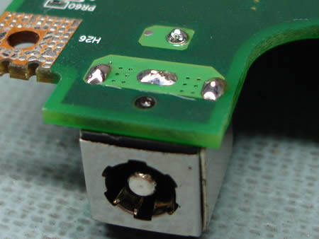

    The IBM Think Pads can run with out the batteries. It is pretty common for where the power cord plugs into the laptop to break away from the motherboard.

    Its a poor design on lots of laptops. The cord gets stressed at angles and breaks that part free, also seen where the inside connections in that block are just worn or bent in such a way it caused trouble as well.
