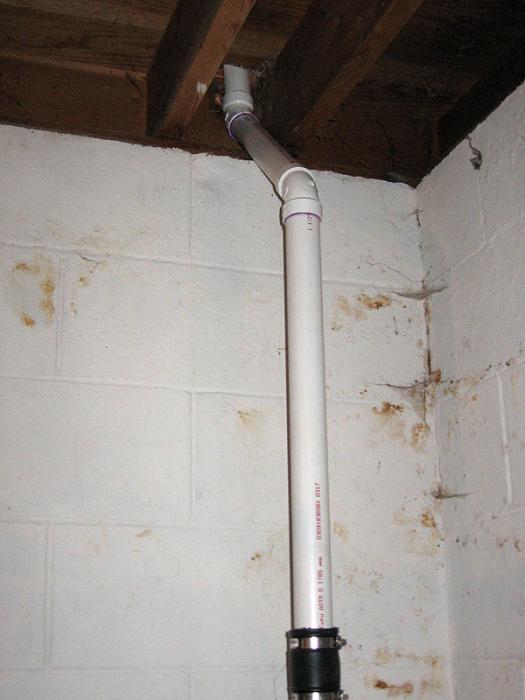

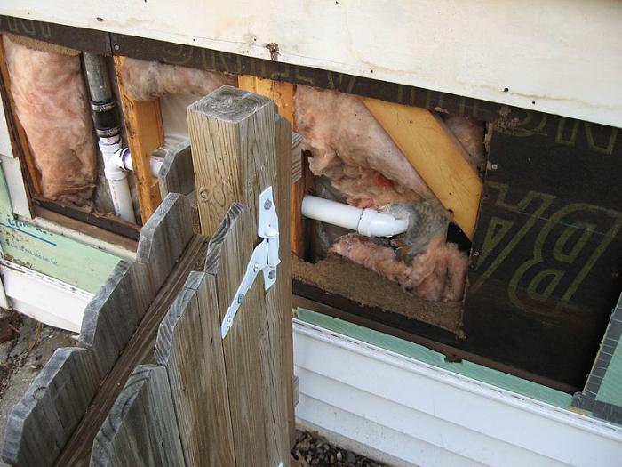

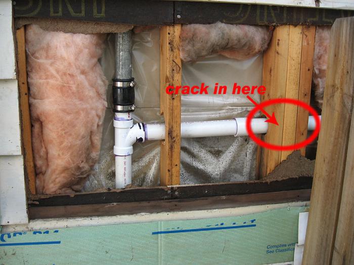

    Had a leaking pipe in the wall behind kitchen cabinets coming from kitchen sink drain. Only way to access pipe was to remove built-in cabinets, or remove outside siding. Called plumber and he recommended removing siding. I removed the siding and had all the plumbing exposed and ready to go.
    He quoted hourly rate of $70. Said should take 1 hour to fix--but 2 at the absolute max- plus parts. "Worst case" he says, 2 hours plus parts- "no more than $200".
    Appointment was at 3pm, they show up at 2pm. Sent 2 guys. They said they can replace bad section of galvanized. I asked them to replace all exposed galvanized with PVC, maybe 10' total, with a few bends and a tee. Ran PVC from existing sink trap to tee, Fernco'd up to vent, and ran PVC down to cast iron stack and fernco'd there. (Pics attached).
    1 guy did most of the work, other helped towards end. They were done and gone by 3pm. Exactly 1 hour to fix. I replaced all the siding later.

    If it was time and materials, the helper doesn't get paid as much as the plumber, but does get paid. Also, many places charge travel time, so 2-hours would give them 1/2-hour each end to come and go.
    But, what is there would not pass code most places...the rubber coupling is only allowed underground in most places. You are supposed to use the thinner one with the metal reinforcement (a no-hub connecter). Those keep the ends of the two pipes aligned properly.

    It's weird how pipe can go bad like that.
    A kitchen sink line has a lot to handle. They are always the first to perforate and need replacing.
    Bars and nightclubs that mix a lot of drinks will eat right through metallic piping, must be the limes and lemons.
