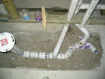

    I'm remodeling (adding a bathroom) my basement. Attached (hopefully) is the layout of the toilet drain I've installed prior to inspection and concreting. I would appreciate any constructive criticism if needed. I went from the main floor drain (3") with a sanitary Y - two 45's - a sanitary T for vent (3X3X2) that goes to the new wall - and ending with the toilet pipe. Oh yeah, the pipe is 13" from the new wall and 16" from anything on either side of the toilet. Other piping in the photo (hopefully I can get it attached) will be covered in my next post for critique... Thanks anyone....

    This description answers my question on your'e first post.Depending on what you did with those vents I think you are ready for an inspection.
    12,429
    I don't know how your inspector was, but most places require that the horizontal waste fittings are wyes and not tees.
    If those tees laying on their backs were wyes, I would say good.

    I took the photo you looked at to my inspector in his office ...... told him I was hoping to save him a trip to the job site just to look at that small portion of the plumbing............and he signed off on the work then and there. Hopefully there are no repercussions.... cause I've already poured the concrete back in...... Maybe he didn't notice the sanitary T vs. a Y .
    Now if he doesn't get picky about my tub overflow/drain connecting to the P Trap with a ProFlex fitting............. poor alignment problem....
    Keeping my fingers crossed....
    Great web site by the way....
    12,429
    Well, that's why I said most places.
    It was okay to do it that way here for many years.
    Now it's not.
    You should be fine.

    Like everything else it comes down to location. Here you can use a TY on it's back as long as you are picking up a dry vent only,however if room permits it is always good practice to install a wye.
    Flexible connector on a tub connection! Only thing I can say is good luck and hope he doesn't have a flashlight.

    Okay, okay.... I get your drift.... Somehow I'm going to have to redo the alignment on the P-trap for the tub... Last thing I want is an inspector looking at me like I'm an idiot.... even if I am!!! On the other hand... if all those flexible connections/flexible ABS downpipes are illegal.... how come it's so easy to buy one?

    Looks like my photography skills are right up there with my plumbing skills..... "Adaquate but not perfect"... The horizontal waste fitting is a wye....

    He was referring to the toilet's vent fitting, and possibly the one where the sink connects.
