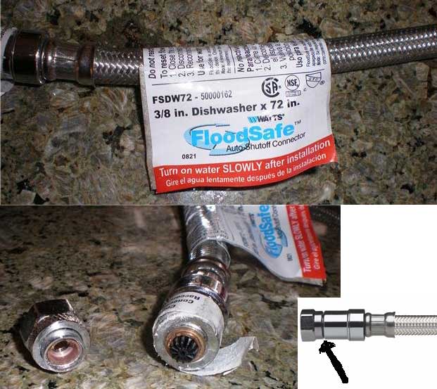

    Sounds like you were tightening a flood safe supply.
    I just post cuz I like to see my avatar.
    25,624
    Default line
    Floodsafes break at the stop, not at the tank. he had a supply with a cracked ballcock connection and tightening it finished it off, making it a broken ballcock connection.

    Oh, yeah!
