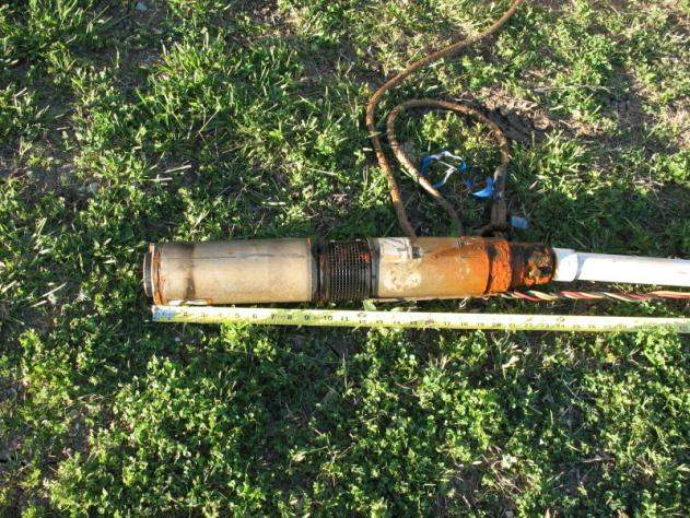

A shroud will keep sediment from building up around the motor. A motor covered with a couple inches of sand won't last long. However, if you have this much sand, rat holeing the motor in sand is the least of your problems.
attachment.php
Unless I am thinking of something different.
How will a shroud keep sand out? Sand will seek it's level just like water.
The only way I can see that happening is the shroud having a cap on top and bottom, and the "shroud" made to look and act like a mini well.

I think Valveman means that by water and sand being forced up around the motor, the sand won't be able to simply fill up around the motor if it were near the bottom.
Like I said, if it's pumping that much sand, it wouldn't make any difference. The pump would be toast before long anyway.

That's true, if it's make a lot of sand the pump is going to be short lived.
But with a shroud on the pump, it will pull even more sand around the pump and motor, as opposed to not having a shroud.

I see the sand mark. We have that same thing happen in the older septic tanks.
With a shroud, it will pull the sand into and around the pump, and will actually make the problem worse.
Do you have a pic of a shroud?
We may be talking about two different things.
The shroud I have used for cooling is a 4" pipe with a open bottom and a cap on top, with holes for the pipe and wire. The pipe will go down over the pump and motor. Mostly used in ponds and hand dug wells.
Then it will pump the sand out and keep it from building up around the motor. Maybe just the least of two evils. I build the tops of my shrouds a little different but, we are talking about the same thing. We have to use them here on EVERY well, because all of our wells are top feeding to the pump.
