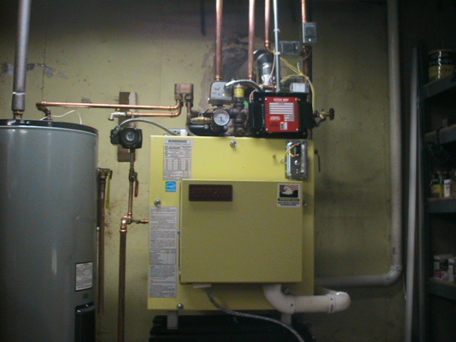

    I like the Pensotti DK2 boiler.
    They are a low mass, triple-pass boiler. Energy Star Rated. Very efficient.
    I have two oil fired DK2-3 (3 section) boilers on a lead-lag setup, that way i get the extra BTUs if i need them. Put them in last fall and saved about 30% in gallons used this winter compared to last.
    I actually bought them online at a website called www.hitechheat.com and had my plumber do the install.
    Saved me a little money that way.
