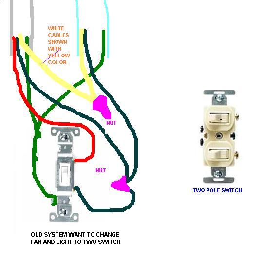

    I am trying to have my bathroom light/fan operate separately, with one switch operating the light and the other operating the fan. The power coming to the switch is 3 wire (black, white, and ground). The wire coming from the light/fan is 4 wire (black, white, red, and ground). I have 2 single pole switches. How do I run the wires to the switches so that the light works from one switch and the fan works from the other?
    I draw a scheme of the situation i hope somebody can help me urgently. (i read on a website somebody had similar situation and answer was he hadn't have extra wire to able to do this.)

    You may not be able to do it without running a new cable. You need to look in the fan assembly and draw what is there now.

    IF power comes to the switch
    Ground continues to each
    Neutral continues to each
    Incoming power goes to each switch
    (Next depends upon which color wire goes where)
    Other side of 1 switch is black wire to one device (fan)
    2nd side is red wire to light

    The wire from the fan is a 3 wire (12-3) with a bare ground, 1st turn off breaker to the fan/light, 2nd remove the fan from the housing to check how the fan is wired up. Should be wired with the black (12-3) wire to the black wire from the fan, the red (12-3) wire to the blue or red wire (color depends on make of fan) both of the white wires from the fan should be wire nutted to the single white (12-3) wire.
    In the switch box.....
    According to the drawing
    Tie all whites together and wire nut
    tie all bare grounds together and put on the grounding screw of the switch
    Black wire (12-2) put on either black screw of the switch
    black (12-3) from fan/light put on bottom gold screw of switch
    Red (12-3) from fanlight put on top gold screw of switch.
    The 12-3 wire to the fan from the switch is the " switch leg"
    The 12-2 wire in the switch box is the input power.
    Reassemble fan and energize.

    According to your drawing you only have one switched wire going to the fan. The black wire is either feeding from the fan to the switch and then on to the rest of the circuit, or power is coming to the switch from the right side and then the black wire is continuing on to the rest of the circuit while the red wire is operating the fan and light. As you said, you do not have enough wires to do the job you want to, unless your drawing is incorrect.

    I did what Chrissimms told and when i did that i see one button controlled light and fan and the other one receptacle on the wall. So i think light and fan connected above so it is an advanced job for me to do. Like most of you said it needs an extra wire.

    The hot power appears to go out to your light JBox and then out to other lights/receps.
    Your options depend on the structure. You need to get from the light JB (probably) to the switch box. You could also (probably) go from the light Jbox down to a new switch location for the fan switch. If it's an old school installation with a wall light above a medicine cabinet, the installation is pretty easy. Just take out the cabinet and you open up access to the wall.

    IF your fan has a black and a red, then one powers the light and one powers the fan.
    If both of those wires are making into yr switch junction box, then you just have to wire one switch's load side to the red, and the other switch's load to the black. Then attach incoming line voltage to the incoming line sides of each switch.
    I've done this on all my ceiling fans and it's worked as expected.
    The existing wiring looks like either the fan or the light (whatever's wired to black) isn't switched at all; the switch is only operating the red. If in your fan box, the line black is capped and the red and black to the unit are pigtailed, then your switch would operate both devices. So, to operate independently, make sure your red and black are not tied togther in the fan box.

    You are thinking of a ceiling fan. His situation is a bit different. Blk is hot, red is switch leg to his bathroom light/exhaust fan.
    The black wire is constant power.

    Thanks for all ideas. Yesterday i checked fan box and decided to put a pull chain switch inside the box and that was easy i have no idea what is what behind the walls and i did not want to ruin the paint and wall.
