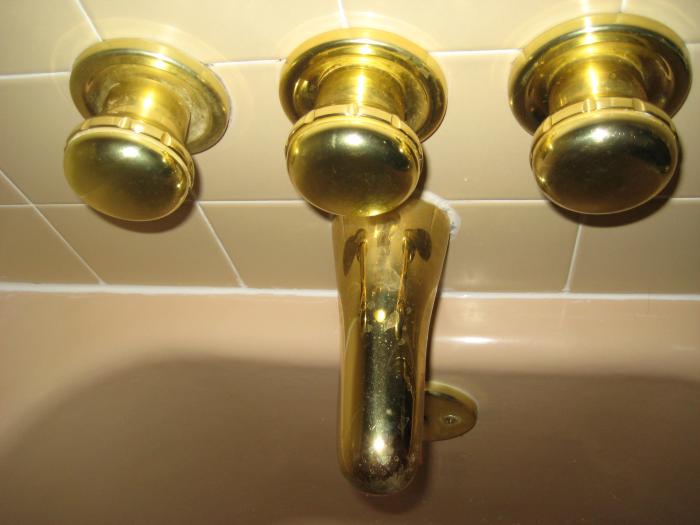

    I just recently bought a house with some leaky shower faucets. My wife hates them. I have searched all over town for “O” rings, but nobody knows what type of faucets I have. Even if wanted to replace the complete faucet I would not be able to do that without knowing which manufacturer to choose from. I really do not want to tear up my wall to change out the fittings on the copper pipes. Does anybody recognize the manufacturer of this 1987 model faucets? The sink ones match the bath tub/shower faucets.

    That is a "third party" faucet, which could use a common base with their specialized trim, so you have to know who made the internals. It could be Central, Price Pfister, or someone else. Once you know that then you can find out if there are other parts still available to change it.

    The handles look like the American Standard, Amarilis

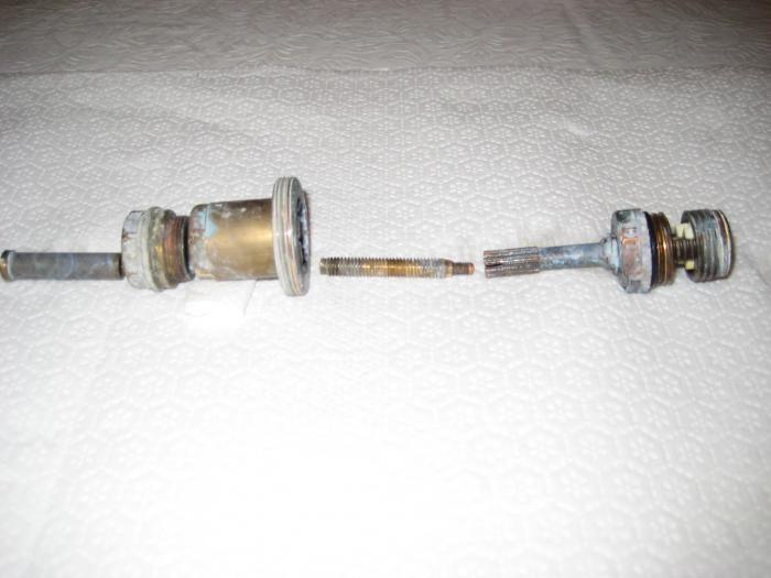

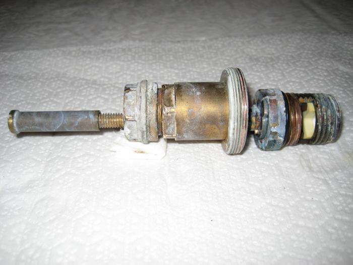

    So..., I could not remove the diverter due to corrosion. I removed the cold water faucet internal parts and took two pictures. The diverter is the same set up. Thanks for any help in advance from both professional and home grown talented plumbers.

    That stepped down stem does agree with the American Standard Amarillus drawing.

    The stepped down stem helps identify it. It has nothing to do with whether some other make or model would work with it. That is a function of the diameter of the stem and the number of splines on the stem. An additional restriction is the escutcheons and they way they attach to the faucet. ALL of these pretty much preclude using anything other than parts from American Standard, and also implies that only Amarillus trim will work.
