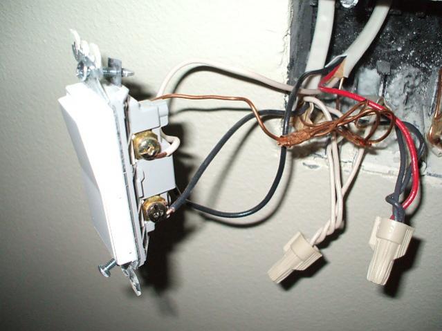

I'm back again
I can't believe it has been this long since I originally posted about this. Anyway, I was able to get this originally figured out simply by cutting the 14/3 that lead from the upstairs switch to the downstairs switch. I ran it to the first 4-way location and two more subsequent 4-way locations, then back to the downstairs 3-way switch and hooked it up exactly as it was by the electricians during the original build. I'll admit that I did this because I could never really make sense of the original configuration of the 3-way switch, but everything worked just fine when I did it. I simply wired all of the like colors together at the 4-way locations and everything worked great.
Now I'm doing the finish electrical and have run into problems installing the 4-way switches. When I installed the first 4-way switch, I wired the white wires together, and then used the black and reds on the four screws. The lights remained on whether the switch was in the on or off position. They only turned off when the rocker was held in the middle position. I moved the black and red wires top to bottom and side to side, but never got the switch working correctly. So now I'm trying to understand the 3-way switch locations to see how to correct this.
The upstairs 3-way switch is easy. That box has just one 14/3 going into it, with the black wire being attached to the common screw. But the bottom 3-way switch box is quite confusing to me. There are four separate sets of wires in the box for this circuit. I've taken a pic so you can see what I'm dealing with. Three of the whites are wired together. Two of the blacks are wired with the red, and the other two blacks are wired to the 3-way switch. The last white is wired to the switch.
Can anyone make sense of this in very clear terms? What is wrong?
I'll also add that I don't think I'm completely stupid when it comes to this stuff. I added a new circuit with 12 cans on it that has both 3 and 4-way switches. That one works just fine. I just can't make sense of the old work.

Red wire is tied in w/ two blacks. Where do the two blacks go? Power in and out perhaps?

The wire pairs on the 4w should be the same colors as the wires on the 2 brass colored terminals on the 3 way switches.
So I should wire the reds together at the 4-way locations and use the white ones on the screws instead?. I don't know why the red wire at the 3-way in the picture isn't wired to the switch? Should the wiring be corrected at the 3-way, or does that configuration make sense to you guys. It seems unorthodox from what I've read.

You cannot just "connect the four wires to the four screws". Two screws are for the wires in, and two are for the wires out, but you have to look at the switch diagram to see which pairs of wires go where. You can connect the wires coming in to either of the two "in" screws and the same with the out one, but you cannot connect one incoming wire to an "in" screw and the other to an "out" terminal. You have mixed yours and therefore the only time it works is at the middle when all the contacts are connected together for an instant.
I did connect the same set of wires to the in screws, and then the other set to the out screws. It didn't work. That's when I swapped their locations and tried that. Still no luck.
