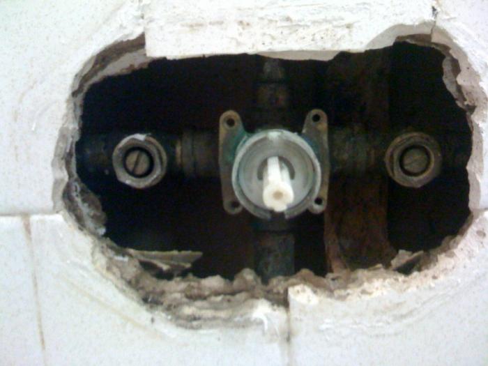

I have what I was told by the guy at the hardware store is a Price Phister (AVANTE) valve. I tried to remove the old cartridge with no luck. :confused:
Is there a retainer clip or screw from the back holding the cartridge in place?
Is it just mineral build up? Any ideas for mineral removal woud be great.

grab hold of the stem with a pair of vice grips and give it a sharp outward tub.
You do have the water turned off, right???

I used the knob (screwed back on) and pulled 'till I thought the copper would break. Wouldn't that be the same as vise grips?
Yes the waters off, but thanks for checking. I've been known to do some bone headed things in my life.:eek:

Take the handle off, then reinsert the screw part way. THEN grab the stem with the pliers, push in, then YANK outwards quickly. You may have to do it several times but it will come out. Pulling on the handle is NOT the same.

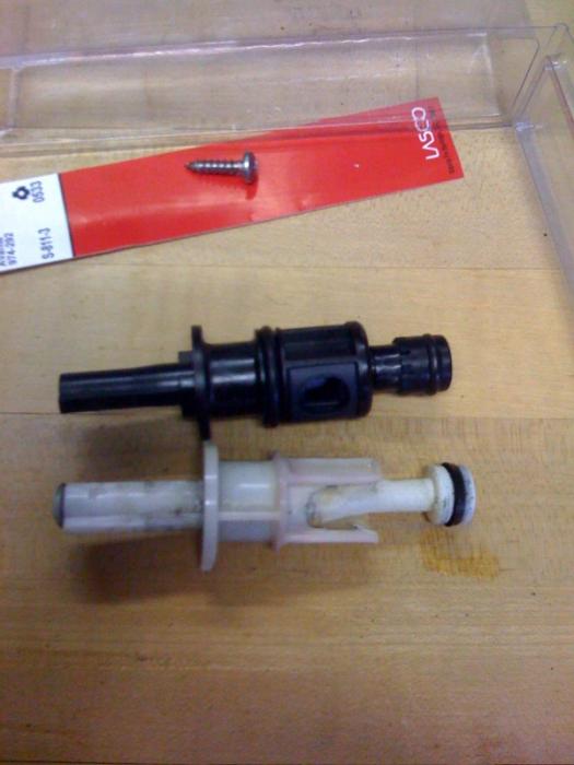

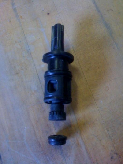

Wait a minute...O c*@#...part of its still in there.
Picture shows old (white) and new with piece missing.
HELP NEEDED!!!

Do you have a flashlight and a screwdriver. If the piece is still in there, and not on the bottom of the bathtub, all you have to do is pull it out. It is just a piece of rubber, and possibly a chip of plastic.

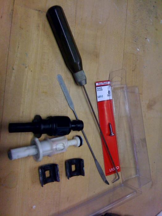

I answered my own question when I removed it. The small end was broken off and remained in the valve body. I was able to modify a small screwdriver and pulled the remainder out.
My question for the real plumbers is why was it broken? Did I over tighten it on install? Is there some formula for proper install?

It was broken because Price Pfister had a bad batch of stems. All the new ones are good ones, but one plumber had to go through about 10 of the old ones before he found one which did not come apart. I had several which did it, but now have the new ones. Call 1-800-PFAUCET and PP will send you a new Avante stem. Then you can put the one you bought, or the new one, back into its package and return it.

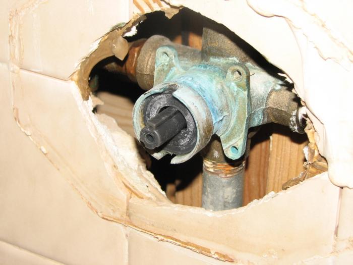

Hello. I'm hopping on this thread because I have the same valve and I'm having trouble getting the cartridge out. The photo shows my tub valve. I reinserted the handle screw and using a vise-grip tried pulling, yanking, twisting, and wiggling but it will not budge. Any suggestions from seasoned veterans?

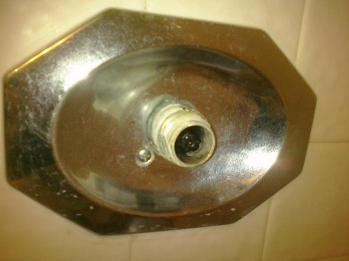

shower valve.jpgOK, it's me again.
Same faucet, only this time the stem broke off and remained in the knob. Any advice on removing the cartridge remaining in the valve body without the stem?
How do I find a quality replacement cartridge?
Are the two slotted screws on either side of the valve body for shutting off the water?

INsert a screw into the remaining stem and THEN perform the previously stated extraction method, i.e., grab screw with pliers, push stem in, the pull out VIOLENTLY, maybe several times. Those are shut off valves.

mission accomplished, the only glitch was the (LASCO) stem was hollow, a little smaller than a 5/16 bolt. I ran a 5/16 tap in it and gave the t-handle a tug and bam! old cartridge out. Replaced with PHISTER from MORRISON SUPPLY this time. This is probably one of those get what you pay for lessons I have such a hard time learning.
