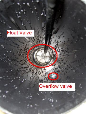

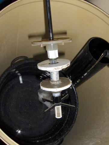

    Turn the Bypass valve to "Bypass". Now remove the top of the Brine Tank and pull the cap off the top of 4" diameter black tube. If you look down the tube you'll be able to see the top of the float.

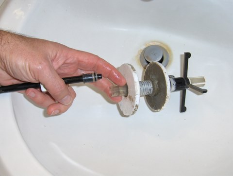

    Find a spot to disconnect the small black tube and carefully pull the valve assembly up. There will be an overflow outlet about half way up the larger black tube which will be in the way - just carefully jiggle the floats (there will be at least two) past it. Here is what the float assembly looks like when removed.

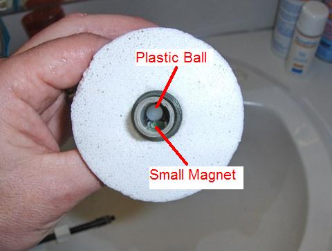

    You'll find that the float assembly will be able to move up and down very slighly (like 3/8" or so). When it's in the "UP" position, water will not be able to flow into the brine tank. If you remove the black tube (careful, there is a small plastic ball inside that will easily go down an open drain. I left my drain open as an example of what NOT to do)
    you'll see that the upper float has a magnetic collar which will cause another magnet inside the valve to raise or lower, thus allowing (or denying) a small plastic ball to seal the tube. I made sure all of these were operating smoothly and reassembled everything. Below is an attempted closeup view of the small blocking magnet and plastic ball.
    After placing the softener water valve back in the service position, I advanced the cycle to BRINE RINSE (actually, it's best just to listen for when water starts flowing through brine tube as the small black dot isn't very accurate) and then left it alone for an hour (it should take 45-60 minutes). When I came back, it had advanced all the way through the BRINE RINSE and BACKWASH cycle and was back in a SERVICE state. I then advanced it to the next BRINE RINSE (for the other tank) and did the same. It advanced completely through that cycle as well.
    So it appears to not be sticking in the BRINE RINSE cycle anymore. I don't know exactly what the problem was, but it appears to be fixed for now.

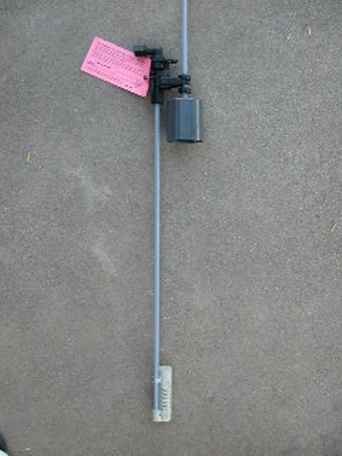

    And seeing that brine pickup tube and float system, a prospective customer might want to think twice about buying a Kinetico softener.
    Check out the simplicity of a real safety brine system. And it costs about a 1/3rd of the Kinetico.

    I would replace the old brine assembly with a new one. It is simple and more reliable. The one you have (styrofoam) is about 20 years old.
    I assume the new assembly is backwards compatible with my model, correct? (Mine is a "Model 60") I'll give a call to the nearest dealer and see how much the part costs and if they're willing to sell me just the part.
    Shoot, only 20 years old? 'tis but a baby still! :-)
