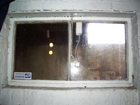

    I have five of these old metal windows in my basement.
    I will need to replace them at some point.
    I was going to hire someone like Lowes to do it, but then I thought "could I do this myself?"
    And I carried on thinking..."could all my buddies over at Terry's place give me some tips?"
    So what would I do? I assume I would need to chip the old ones out by chipping the brick on the inside. Is this right? What would I use? The rotary hammer?
    Or would I cut the window to get it out?
    And how would I measure for the new ones? And how would I fit them in? Screws? Cement? Caulk?
    Or is this a no-no for a DIY?
    Just the small basement windows. The upstairs ones are double-glazed, vinyl and fine.

    Although I don't have extensive window experience, I do have enough to point you in the right direction.
    You should not have to break any brick to get the window out, unless there is brick that was built around it after it was installed.
    You can either use cement screws into the brick like you did with the bottom plates of your basement walls, or you could build a wooden frame first out of pressure treated wood.
    When you measure it, you always take the smallest of the measurements. In other words if you are measuring for the height: first you measure the height of the left side, then the height of the right side. If the left side measurement was 23 7/8" and the right was 24", you would use the 23 7/8" for the height. Same for length. Then order it that exact size. After you install use expanding foam around the window gaps (that stuff is pretty strong when it dries and will help hold the window in place). Cut the excess expanding foam away and install your mouldings.
    Good luck.
    Gabe
    Don't follow my advice, I only know a thing or two about a thing or two.

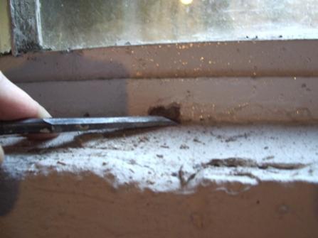

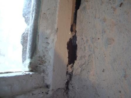

    Thanks GabeS. Some of the window frame appears to go a little into the brick (about a half inch), as if the house was built around these.
    Should I cut the frame to get it out? Or chip away from the inside?
    It's not in the brick at the bottom edge. I can get my chisel in here.

    But at the sides it is tucked a little behind the inside wall.

    I would build a frame using extruded PVC instead of regular douglas fir or pressure treated lumber. This will eliminate the need for any maintenence that doug fir would entail such as regular painting and eliminate the issue of shrinking and warping that PT lumber usually has because its usually so wet.
    Then depending on what kind of window you put in, you can use the full opening in the foundation and secure the window with another PVC frame (like door stops) or use the PVC as the rough opening and install a window in the opening, later using expanding foam and trim. Just be careful with the expanding foam you use as some will expand too much and can make windows inoperable. Great Stuff Window and Door is minimally expanding and readily available.
    Is it time to chip?
    It looks like the easiest way might be to remove the glass, then take a sawzall to the steel frame, and pull the pieces out? ... less chipping, that way? Hard to tell from the pictures, if I'm "seeing" it correctly.

    Thanks for all the tips. I am not quite sure how to measure these. From the outside or the inside?
    The measurements are about 1/4 inch smaller if I measure from the inside. But surely the new window will come in from the outside, so those measurements are the ones that matter no?

    I agree with frenchie. Break the glass and remove it. Then work the frame out and be careful not to damage the surrounding masonry too much as the will be the base for you new window or rough opening.
    A sawzall is a nick name for a reciprocating saw. The tool with the blade that goes up and down, sort of like a fast knife. It's a must have if you are doing remodeling work. I feel naked without my sawzall.
    My guess would be to use the measurement of where the window is going. If it's going toward the outside then use that one. If it's going toward the inside of the opening then use that one.
    I would remove the window completely and then measure the opening. While you are waiting for the replacement you have to board it up and put plastic so no water gets in. Myself, I wouldn't attempt to measure and order the new window without first removing the old.
    Gabe
