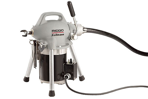

    hi everyone, first of all i'm a new bee for this site. I bought a used ridgid K50 w/o a cable. Today i got a size 5,8' cable for this K-50 model. Does this model feed the cable itself? when i pressed down the clutch the cable is turned but it does not feed itself. Do i have to push the cable? please help
    Nov 2008
    Chicago, IL
    1,705
    You have to pull out enough cable then press the lever to spin the cable and feed in the slack. Then release the lever pull more of the cable out to get a little slack press the lever again and feed in while its spinning. These cables come in 7½ feet sections and there should be a guide hose that attach's to the back, you only feed in the 7½ feet at a time. Be sure when the cables click together that you see the pin pop back up.

    The sectional machines the only one that has it right is Ridgid or Rothenberger. I do like that Rothenberger large machine the R750 can turn the 1¼ cable and the ⅞ cable with out any changes to the machine. Then you can insert a clamp clip to spin the ⅝ cable and they do make clamp clip for smaller cables as well, so one machine to rod drains from ¾" to 8" lines is impressive to me.
    Now drum machines the only way to go is with a Spartan tool machine they by far are the best compared to General Ridged, Electric Ell, DuraCable, Marco, and all the other drum types out there. I carry a K-50 with 75' of ⅝ and two drums one with ¼" cable and the other with ⅜" cable on my truck along with a Spartan 100 and a 1065. Also have a pistol rod a Ro-Pump, a small electric Viking Jetter, and a kinetic water ram, along with my assortment of toilet augers. Oh almost forgot my two canvas sludge bags a 4" and a 6", oh and a 125' hand rod with three ball sizes.
    Now I have other machines like the Electric Ell Model C its great for crawl spaces. A Ridged K-1000 for rodding 8" to 24" sewers from manhole to manhole. A few Ridged main line machines K-500, K-1500 K-1500 lowboy. Which all I have used I find each machine has its place.
    Now for picking a drum machine over a sectional machine. I can not really do that. There are times where I am in the mood to use a sectional machine for a month or two, then I switch back to my Spartans. I found that the sectionals do great with soft blockages and grease. Where a drum machine works wonders with heavy tree roots. Yes a sectional machine can clear tree roots if you take the time to work the cable a whole lot more. Where as a drum machine you can get a "bite" into the roots and build up torque to tear them up.
