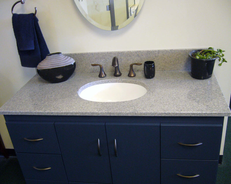

    I looked at three bathrooms I did in cultured marble ten years ago, and they looked pretty good.
    It's a very nice product to use.
    http://www.veronashowers.com/master-bath-pictures
    Designers Marble in Woodinville WA
