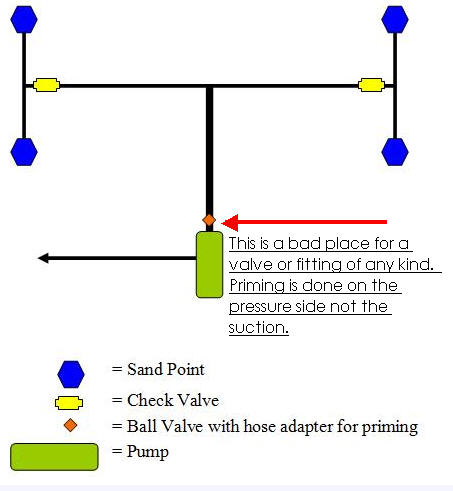

    Thanks Bob. Thanks everyone for suffering my questions. I have a couple more...
    1) Should a sandpoint system lose prime? I would think not, but it always has. I have a self-priming pump so it does prime itself after about 3-4 minutes.
    2) If the answer to #1 above is NO, then is it possible that the pump is losing prime on the discharge side? Reason I ask is that the pump cavitates and temporarily loses prime when it switches between zones. Seems like this would not be the case if the system was tight on the discharge side.
    Here is a bit of potentially useful info.
    I have 4 sandpoints that are joined together in shape of a Captial "H". They are all equal distance to the pump. See my crude diagram below. All pipes are PVC and are 1-1/4" except where it comes from the middle of the "H" and goes to the pump. That pipe is 1-1/2". The points are minimum of 10' apart for recovery. See my crude diagram below:

    I like where you have your check valves.
    If your pump loses it's prime, it's because you have an air leak somewhere in the suction line. If it's on the point side of the check valves, it allows the water in the well to seek it's static level and when the pump sees the air after starting up, it loses prime.
    Putting any fittings in a suction line that are not absolutely necessary is a bad idea.
    bob...
    By pressure-side are you talking about the discharge side? The pump itself does not have a plug or fitting for priming. I do not have a tank.

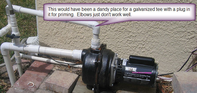

    A picture is worth a thousand words.
