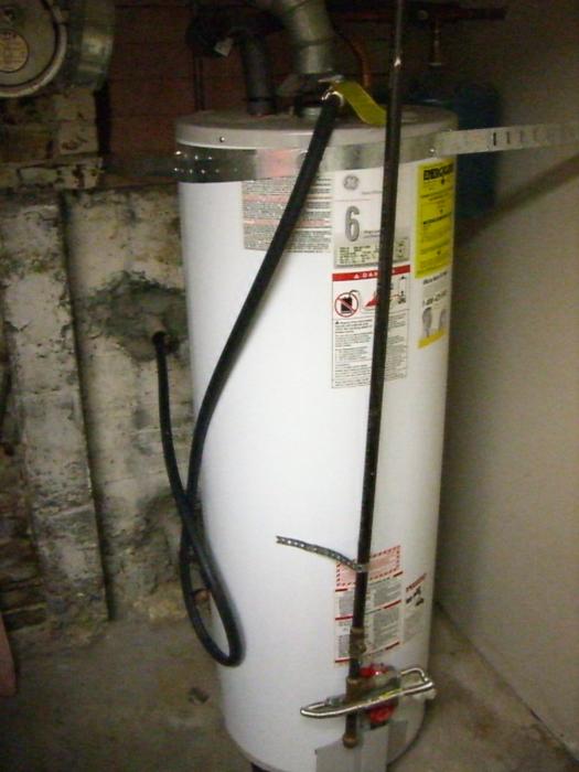

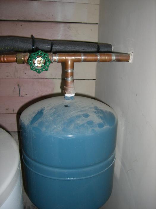

    My house is 3 stories. I have a gas water heater (<8 yrs old). Attached to the water heater is an expansion tank with a valve at the top.
    [Side Note] From reading this forum, the first thing I learned was that I need to get some support under the expansion tank, which I plan to do asap.

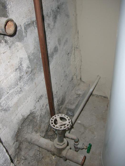

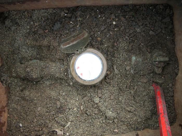

    However, as seen in the pictures of my setup and of the street meter, I am not sure that I have a closed system. I don't see where I have a any sort of checkvalve except the one at the top of the water heater. As another sidenote, again using this forum, I replaced that valve about a year ago because it started spewing water (luckily I had my water alarm on the floor!).
    I attached the black hose in the picture and have it draining outside through an old pipe in the wall.

    2. What should the expansion tank's gate valve be set too? I've tried opening and closing it but it doesn't seem to make a difference.
    3. I've also tried slightly closing the valve to the water supply to the house, without success. I even tried playing with the valve under the faucet to no avail.

    But who installed that water heater...

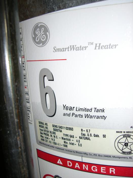

    Oh, and it was installed when I bought the house in Jan 2001. What's wrong with it? I've entertained the idea of putting in a tankless water heater, but with the economy the way it is, I'm hesitant.

    I am suprised the home inspetor did not gig the hose from the T&P Valve, and the gas piping.

    According to the serial # it was not manufactured until April of 01 unless they changed how they date code.

    Is the expansion tank before the heater and after the city connection(with shut off)?
    Or is it after the heater? You'd need to put everything in the proper order as well as add a PRV to make it a closed system.
    That gas line(as mentioned above) is questionable. Did you have it inspected after it was installed?
