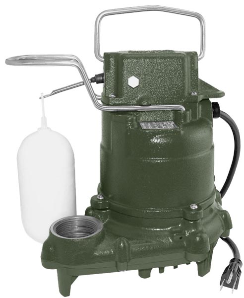

    Is this the pump? It`s an M57

    I think it's the "N" version, which doesn't have the attached float.

    The only N57 is the oil smart system.Can you send a picture?

    This is the one I'm referring to.
    http://www.irawoods.com/Zoeller-N57-...category=48898
    A photo would not be very telling. The thing is mostly covered in sewage.

    It is the basicly the same as the one I showed earlier.
    Get some rubber gloves and toggle the arm coming out of the side at the
    top several times to see if there is an obstruction.Un plug it first and
    toggle the switch the plug it back in and toggle while plugged in.
    Then run water to see how it operates.
