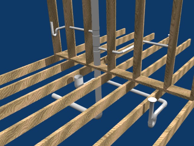

I've attached a few pics for discussion purposes.
The first shot is my original proposed DWV with the floor joists and wet wall studs in place.

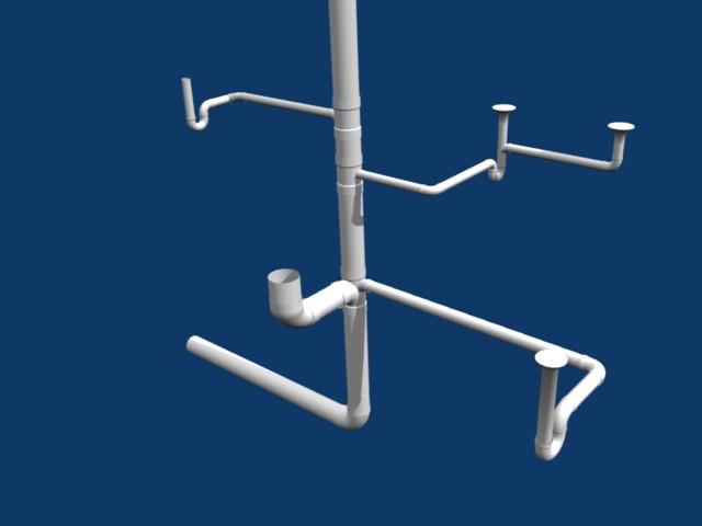

The second is the same DWV setup as the first without the floor/wall.

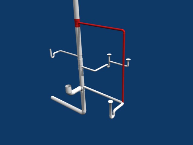

The third pic includes an additional vent for the shower.
Am I going in the right direction here?
One plumbing book I have, indicates that you can stack vent a drain if it is within a certain "critical distance" from the stack.
All my drains are within that distance.
So, is the book steering me wrong?
I want to do things right here, but I also don't want to bore a bunch of holes in the wet wall if they aren't needed.

Your 3rd drawing looks okay to me.Codes vary state to state some want
each fixture vented separately,others do not.
