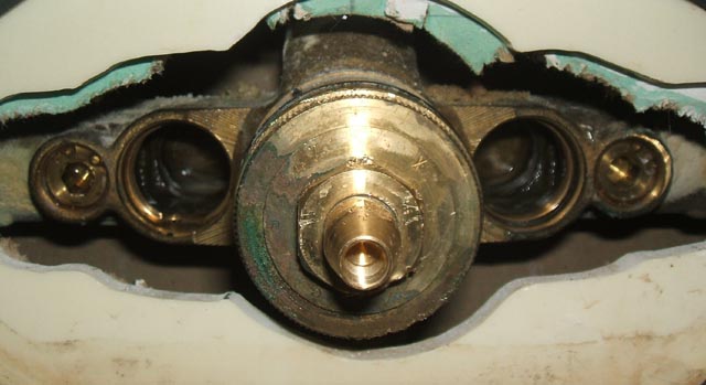

It's a temperature control with seperate volume controls. With my limited knowledge I would suspect the crud issue. Water is slightly hard. So, is the cartridge in the center of the valve? Are any special tools required for removal. I wasn't able to remove anything past the exterior knob (trim & temp ring, etc.). I may need a bigger pair of channel locks if that's all it should take. What about calibration? Is there any trick to that?

Sounds like a thermostatically controlled valve. Each one is slightly different, so the best thing to do is probably call or e-mail Grohe. I was able to get the installation instructions from them as a .pdf file. They can probably help you figure out which valve you really have as well. There are really two valves in there, and I'd start with the volume control - you don' thave to calibrate that! On mine, there's a big brass screw down the middle of it...remove the screw then pull it out. Can't say on yours. If you post a picture, somebody may recognize the model and be able to help.

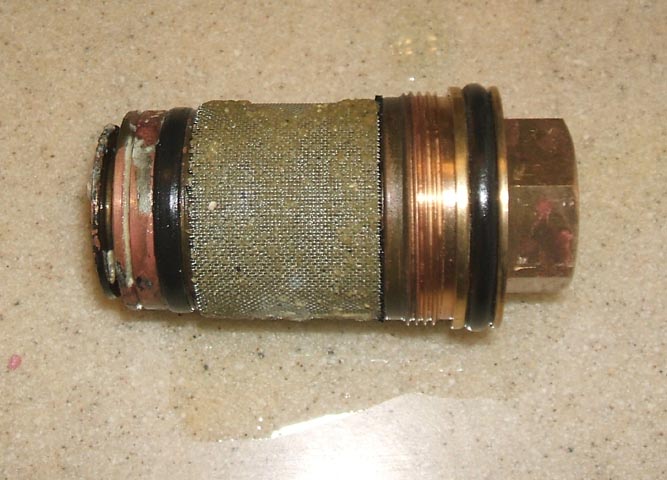

Here's what I've got. The Check Valves are removed and pictured. They obviously needed cleaning, which I've done. I now have pressure back but still have temperature fluctuation. Do these need to be replaced? I still can't get the center section removed. I can't get it to unscrew. Any tips are appreciated.
