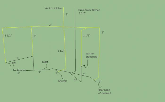

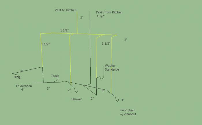

    Another venting question. I wish I had a picture for you but I hope my description is enough. Here's the situation. I am installing a bathroom in my basement. I have removed the old floor drain in the corner that fed via a short section of clay pipe to the 4" line to the aeration system outside. The 4" line enters under the footer and immediately connects to a 4x4x2 wye with 45 facing up to serve as the drain for a sink. The sink is about 3' from this drain but I will probably vent it separately above the trap.
    Extending straight out from the 4x4x2 wye is the toilet location, about 18" from hub of wye to center of closet flange. I have sized down to 3" out of the fitting with a bushing. If this were all then I could use the sink drain as a wet vent, but there is also a shower next in line, then a drain from the upstairs kitchen, then the washing machine standpipe, the a floor drain. All of the fixtures from the shower to the floor drain will have their own vents connected in the wall 6" above the bathroom sink and a single 2" vent will rise to the first floor and connect in to the kitchen vent pipe 6" above the sink. My question is what is the best way to branch off of the drain for these additional fixtures. Here are the options I am considering:
    1) between first wye fitting for sink drain and closet bend I install a wye fitting leading to the other drain locations. This would leave me no room to separately vent the toilet. The sink would be the wet vent but my concern is the other wye in between. Would this be allowed. I could install a vent tee turned up after the second wye fitting for the additional drains but it seems that this would be no better than using the sink drain as a wet vent.
    2) instead of a closet bend for the toilet I install a long sweep wye. I have plenty of depth for this. This would allow for a vent tee in between the sink drain wye and the toilet. I would then continue on to the other fixtures venting each as noted above.
    It seems ideal to me to vent each fixture arm between the trap and the connection to the main line but space just doesn't permit. Sorry to be so long winded. Someday I'll learn to post drawings.
    Scott
    Default Picture
    I'm sure a picture will help. All the distances are quite close between fixtures. Any suggestions?
    Scott

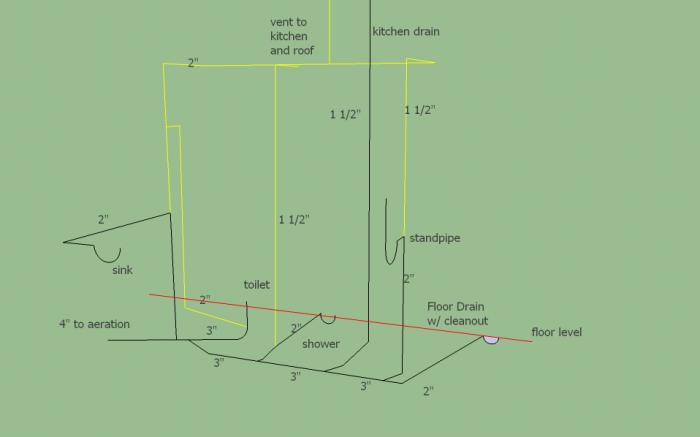

    If those vents for the shower and floor drain, run horizontally under the slab it will not be legally vented. No part of the vant may run horizontal until it is 6" above the flood level rim of the highest fixture served. There appears to be 2 vents for the lav ? The toilet does not need to be vented.
    Default Vents
    Thanks nhmaster
    Ok so I can remove the vent coming up from the sink trap or the wet vent portion. Critical distance isn't a problem so I guess it doesn't matter which one I remove does it?
    How do you suggest that I vent these pipes in the slab? Will I need to route my horizontal drains so that I can I can point a tee straight up into the wall, say next to the shower? This will be more of a challenge due to space limitations but I want it right. I didn't take the time to put the walls in my picture but the toilet is in a 30" nook between the exterior wall and the shower wall. The shower stall is 36". The standpipe will go in the right wall of the shower and the floor drain will go 3' or so further than that. Could I run 3" to the base of the standpipe and then on to the floor drain, using a 2" vent for the standpipe to wet vent the floor drain or does it require it's own? I thought that the vents could come off the drains in the slab as long as they were tilted 45 deg or greater and sloped up toward the wall where they would then go vertical. I trust you guys though.
    Scott

    that works
    Smile Thanks
    So just to be sure, my bottom picture will work with the floor drain vented through the standpipe wet vent. That will save me a little time.

    The vent for the shower...
    Is that 1 1/2" below the slab?
    2" is minimum underground.

    MN code gets us ...
    the floor drain can be 25' from a vented line,and your min. waste underground is 2".
    It does not say the minimum *venting* underground is 2".
    We have to get and individual vent on that toilet before it hits the main.
    Good luck hefty.Where are you located?
    I am in Illinois Jay. I though I might need a separate vent on the toilet but the spacing is so tight. After the main enters the house there is an immediate wye w/ 45 for the sink drain. From the outside of the hub to the center of the toilet flange is only 18". I cannot fit another 3x3x2 wye inbetween the two. Would it be possible to use some sort of wye with a side inlet for the closet bend? nhmaster will surely make his point about horizontal venting in the slab though. Nothing on this 5+ year house remodel has been smooth and I guess that is why I have learned so much. But I sure would have liked for the main to enter just a little to the left or right of where it is. Any ideas on close quarters connections would be great.
    Thanks, Scott
    Default toilet venting
    Here is a new drawing. I have very limited horizontal space to insert a vent for the toilet between the closet bend and the main. I do however have enough vertical space to insert a vent tee between the closet bend at the bottom of the trench and the top of the slab. This vent would run horizontal for about 18", but not flat horizontal, I can probably get 22 deg upward pitch to the exterior wall. Is there any reason that this will not work, or more specifically that it is against code? How else do you vent a toilet on a horizontal main if the branch pipe does not come directly under a wall?
    Thanks again. The inspectors around here I have found are not that strict. I spend a lot of time making things above code and they usually don't even notice. I want to do things right regardless of who looks.
    Scott

    So it appears that there is and always will be some disagreements on horizontal venting. nhmaster, in your opinion it seems as though I am ok not to vent the toilet separately but others say that it is necessary. The toilet is 18" from a vent wet vent. Other than digging back under the footer and splitting off the main sooner I do not have room for a separate vent on the toilet. Like I said in a previous post I do have room in the horizontal piping to the toilet to install a tee and possibly even a wye with a very short (17") sloped horizontal vent to the wall. I cannot see how this would cause a problem. I am ready to start installing pipe but will not do so until I am convinced that I am doing it right.
    Thanks, Scott
    Nov 2008
    Chicago, IL
    1,705
    If you are in Illinois the smallest pipe you are allowed to use under ground is 4" pipe. Water closet must have its own vent tied in after the closet bend rolled off the top with a 4"x2" wye then vented to the nearest wall.
    Your best bet is to draw up your plans and take them to your local permit office and have the plumbing inspector approve them. I would also get a permit as well, if you get caught doing this work with out a permit the fines in Illinois are very hefty. Also double check with the inspector their are parts of Illinois that do not allow PVC under ground, and there are still parts that do not allow PVC to be used in drain systems that have metal pipes. I know they make fittings and such to transition from PVC to steal, CI, or even copper, but them are the rules in that town.

    Thanks sewerratz, I think. How close are you to Fairview Heights and do you own a shovel? It looks like I am going to have to cut out the wye that I reduced to 3" under the footer. Any recommendations for cutting 4" pvc when I cant get a sawzall in there?
    If I cut it back far enough I may be able to produce enough room to roll off a wye in the horizontal toilet drain. If not do you think that there would be a problem installing a vertical wye in the riser for the vent as shown in my last picture.
    Also, should I use 2" min for all pipes entering the slab? It sounds that the code addresses drain pipe but not necessarily vents.

    2" for all the branch drains is correct. so venting has to stay 2" as well.
