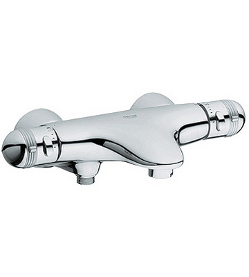

    HERE IT IS: But discontinued...And I don't think it will do for us.

    Danz has a D500155 2 handle with vales that is pressure balanced. It is unusual in the the 2 valves, one for temperature and the other for flow volume, are set up horizontally with an 8" spread. For about $155, it also includes the valve body, But I don't think folks here thing much of Danze--is that right?
    19,199
    Their website says limited availability so it may be limited to stock on-hand. http://www.grohecatalog.com/product/34066/
    Basically, its an externally mounted valve, tub spout with a built-in divertor. The second outlet on the bottom is for a hose for a hand-held shower. I've got a shower bar holding the hand-held. It's handy when cleaning things up since you can move it around easier. Except for the handles, the body of the thing is solid brass and probably weighs 10#.
