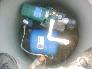

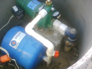

    This is my first experience with a well/pump as I've always had city water. However, I checked and checked again (both inside the home and on the well itself) and there is no pressure gauge for the bladder tank. None! Therefore the only thing I have to go by is the pressure gauge on the pump itself.
    When the water is OFF the pressure gauge on the well pump reads 36. It never falls below this number...never. And I repeat that's when the water is off and the pump is not running.
    When I turn a household faucet on the water on the well pump kicks on about 15 seconds later and the well pump will run for about 90 seconds and the gauge on the well pump will climb to 52 and then it shuts-off. I monitored this several times through out the course of several days and noticed that the pressure gauge on the well pump will then slowly drop to about 46 (it takes about 2.5 minutes for it to drop to this level) and then the pump will kick on again.
    There is no CSV valve installed between the pump and the tank and the pump sits in a well housing and its bout 1 foot above grade.

    Your pressure switch settings seem to be 46/52 (on/off). The two numbers should be 20 lbs from each other like 30/50, and the air pressure in the pressure tank should be 29-28 psi with no water in the tank.
    You should not buy that water treatment equipment. It is way overpriced and uses mixed beds which is a bad idea. It is not good for your needs. You should get water tests for hardness, iron and pH at least. Then post the results.
    Yes you need a 1" main line. I suggest PE (polyethylene) pipe that you buy in a roll for as long as you need and it should be 160 psi rated.

    He has not yet learned how to check the tank pressure.
    If it is a bladder tank, there is a schrader valve near the top of the tank. The tank must be drained completely off all water, then the bladder pressure is measured with an automotive-style tire pressure gauge at the schrader valve.
    If there is not a schrader valve, then you will likely note that the tank has an inlet pipe and and outlet pipe. If that's the case, it's not a bladder tank.

    My question is when bleaching the well can't I simply remove that top 3/4" cap and then feed a tube down there hooked to a funnel and then pour the water/bleach solution down that?...or do I have to remove the entire flange and pour it down the casing directly?
    What you have is a two inch deep well system. There is a single pipe jet down in that two inch pipe hanging on either 1" or 1-1/4" (hopefully) galvanized pipe. You cannot pour bleach into your well without removing all of the above. This is a job that needs to be done with a pump hoist and a professional. It is not an easy job and if you move that blue gadget (casing adaptor) on top of the well, you will then HAVE to pull it.

    Speedbump is right about what you have. Even if you took that plug off the well head or removed the well head it self, you would only be chlorinating the water in the 1 1/4" pipe and the water between the 2" pipe and the 11/4" pipe. The jet assembly has packers that keep water from shooting down the well when your jet pump turns on and that's what allows the water to be circulated through the jets nozzle.Withot the packers water would be lost down the well. That circulation through the nozzle is what creates the vacuum in the jet and allows water into the system . There is a valve in the jet and a foot valve attached to it and both keep the system under pressure when the pump shuts off. If that nozzle is plugged in the jet it will cause issues with volume and pressure. Seeing that you have an iron problem, the jet's nozzle may be plugged and the jet should be pulled and replaced. With the jet assembly out of the well, you could then properly chlorinate it. Putting a bigger pump on the well will not make any difference if you have a clogged jet. Before you start digging up waterlines, i would have this checked out. Pulling a jet is not a DIY job and should be be done by a pro.
