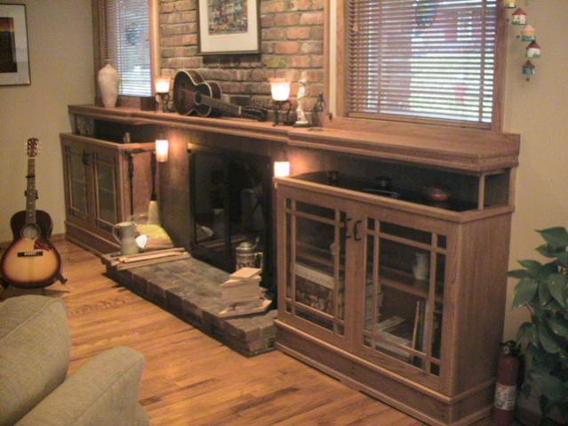

    I don't know if it will help at all, but I have built my own mantle. It's just that it's probably not what you have in mind in terms of style, but I will say that it's probably the longest one most people have seen.
    There used to be floor to ceiling windows, but we wanted a more horizontal look with practical applications.
