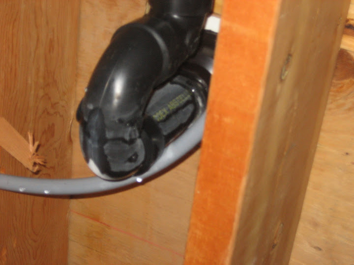

When the shower was turned on, i could see water spraying like crazy. I was then able to cut another hole in the ceiling directly under the trap for the shower with the leak (the one we use all the time of course!).
Here's a couple of pictures I took of the trap from underneath.
After looking at the drain up close, I discovered that it looked like the drain trap had become detached from the shower drain itself. Bear in mind, I've lived in this house for nearly 5 years and we use this shower daily! I have no idea why this would break now and how it have happened. To my knowledge, drains like this don't just "break".
Upon further examination, I went up and looked at the drain from the top. Here are a few top views... One of them is the drain itself. Another shows a small screwdriver pushing the trap away from the drain. This where the leak is. Dorry for the poor quality of some of these pics. My camera kept wanting to use the flash and it makes the picture look a little weird.

So, here's my questions....
#1 - any ideas why this would break?
#2 - is this straightforward enough to fix?
#3 - I assume I will need to tear out all my wet dry wall as it will likely grow moldy. Is that an accurate assesment?
