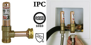

    We also get an awful rattling noise when the washing machine is filling, and a loud bang when we shut off the faucet in the kitchen. I have drained the lines a couple of times thinking it was air, but it never fixes the problem.

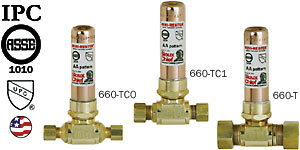

    The banging is water hammer and can be helped by the installation of a water hammer arrestor...you may want to check and see if you have a pressure reducing valve that has gone bad as excessive pressure could cause this to start.... the other noise sounds like you are describing water falling down the main stack...there would be little you can do for that with out tearing out walls and soundproofing the area which in most instances would not do a whole lot to reduce the noise because in most cases there would be little room to add sound reducing insulation...
