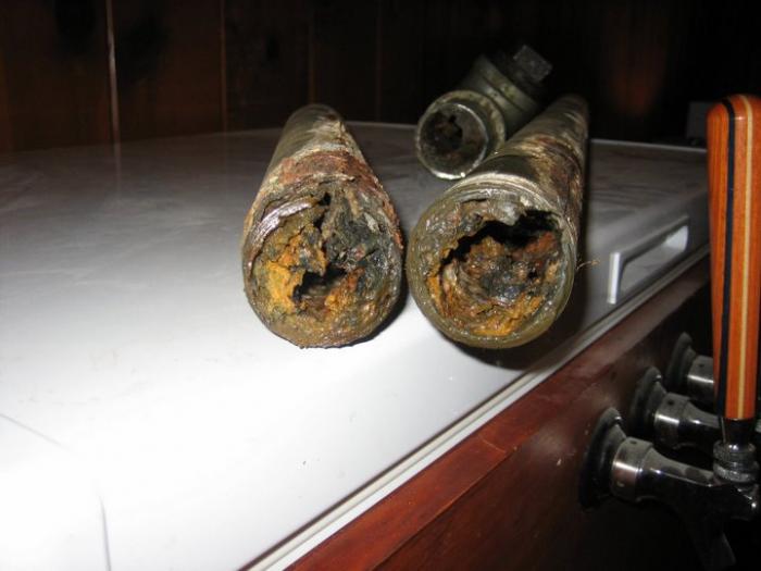

I had this same issue after my kitchen remodel. It was fine for a couple of months.. then I think because we were running a disposer through 50 year old clogged galvanized pipes, it clogged so bad I couldnt get anything to drain after snaking for a hours.
I ended up ripping out the basement ceiling and cutting out all the galvanized. This is what the pipes looked like:
Looks like you made the right choice!

Is that a tapper? How dare you soil it's habitat with old dirty pipes?:D
Haha.. yea thats my kegerator... Getting things dirty didn't matter much after i cut into that pipe with a sawzall and got a faceful of sludge..
Really though.. like Redwood said it was the sludge that stopped those pipes from leaking. Amazingly, there were NO LEAKS in this pipe, just backed up into the sinks.
I have ran into many sink lines after I unclogged them they leaked like sieve.
