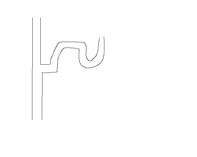

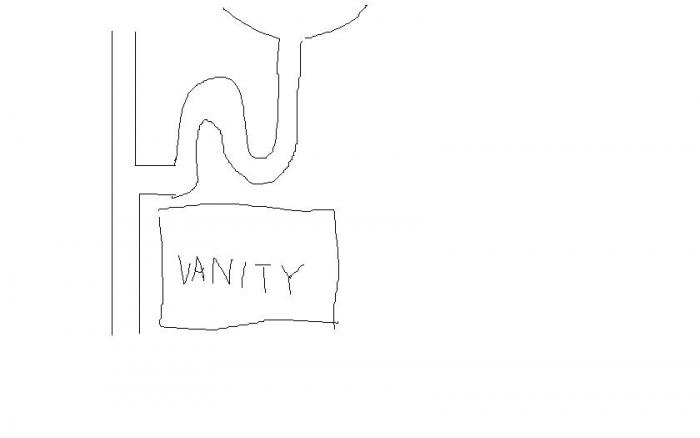

    Hi Everyone,
    Looking for a little advice. I have a vanity that has a "drawer" under the sink (see attached pic) so I'm unable to install a proper P-trap. That leaves me with the dreaded S-trap. But after searching this and other forums, I haven't been able to find an adequate answer to my issue. It looks like most S-trap issues are unvented, or otherwise attach to vertical drains. In my case, I have a vent only 4 inches away from the end of the "S". I just don't see a siphon happening. At the same time, I could envision possible gurgling. So here's the question, is this a rare instance where a S-trap is acceptable?
    As I see it, I have 4 options.
    a) Install the S-pipe as shown in the diagram.
    b) Raise the T joint about 5 inches and install a proper P-trap
    c) Cut the vanity and install a proper P-trap.
    d) Increase the horizontal distance between the trap and the other half of the "S" thereby converting it to a legitimate P-Trap. I've heard that I need at least 2 times the pipe width. If I have 1.5 inch ABS, would that mean a horizontal run of 3 inches? I think this would fit.
    My instinct tells me that the best ways to deal with this (in order) are b, c, and d. I'm hoping that no one finds an issue with a) but it's probably unlikely.
    Really appreciate any commentary.
    Thanks,
    Mike

    Raise the tee.

    Well, by that short answer, I'm assume that a) the S-Trap is out. I figured as much. Let's further assume that to move the tee I'm dealing with cast iron and replacing tile that just can't be found or replaced. So I'd rather not do b) either.
    If I implement the d) solution, it'll probably pass code, but will there be gurlging? (In which case, this is not a viable solution for me). Is there any plumber out there that can tell me that "yes, that is legal (barely) and that should work correctly"?

    Also, a quick image of what I mean by the d) solution. A P trap where the "run" is equal to twice the width of the pipe width. So, 3 inch run for 1.5 inch ABS. It's not clear whether this should be twice the width of the pipe or twice the width of the entire trap diameter (around 8 or 9 inches) using 1.5 inch ABS.

    Thats still an S-Trap

    solution D will never pass code either. No matter what you do you need a P trap configuration there.
    9,004
    As long as you have a drop before the vent, you have siphon potential, and it will be ruled an S trap

    This morning I knocked out the drawer in the base of the vanity (which surprisingly also gives me more room to store stuff) and installed a correct P-trap. Thanks to those for addressing my specific vented S-trap question.
