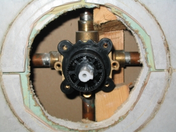

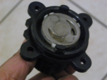

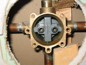

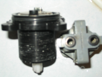

Hello everyone,
I badly need your help in identifying the manufacturer / model of my shower faucet (photos attached). It is leaking water & I guess I need to replace the cartridge.
Unfortunately there aren't any logos or model names on the unit. I tried few local hardware stores and no luck so far. Thanks in advance.

Price Pfister OX8. Pretty common stuff. Any plumbing supplier ( not necessarily blue or orange ) will have it.
