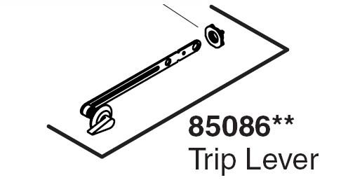

    Hello All!
    I'm being coerced into buying a Kohler Devonshire toilet because of the style and the lever matches our valves. I may be able to talk my wife into the Toto Clayton, but I don't think that they have a matching lever.
    Do anyone know if the lever from a Kohler will fit a Toto Clayton?

    The Kohler trip lever is different from the Toto.
    The Toto trip lever curves out because the tank itself curves out in the front.
    You would have to be able to bend the Kohler trip lever and i'm not sure if you can because it looks like it's made of plastic.
    Kohler
    Name:  Kohler trip lever.JPG
    Toto
    Name:  Toto trip lever.JPG

    George,
    If you have a heat gun (the kind used for removing paint, etc) I believe you could carefully warm the plastic Kohler trip lever and bend it slightly.
    Boiling water may be a safer, cheaper option, and then a quick quench into cold water would set the bend.
    It takes some practice, but the plastic trip levers available in the hardware store would give you something to practice on.
