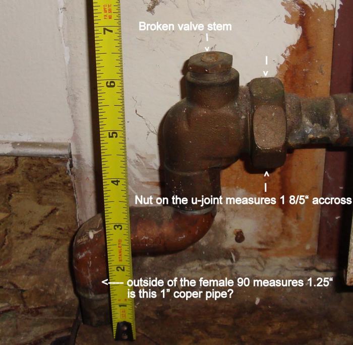

have a apartment complex that has a huge boiler on outside and runs hotwater through the plumbing lines for heat. I'm guessing that the water goes through radiator(in my ceiling) then the blower forces the heat through the ducts, after a while the water recirculates to bring in new hot water?. Well there is no heat, I got the thermostat to work and now the blower works but there is no heat. there are 2 pipes both with shutoffs and they feel warm(update got them to get really hot), not hot. When I turn on the thermostat and blower kicks on one pipe is hot(see pics) and one gets cold(see pics). I dont' feel no heat, am I being impatient and should just leave the blower on and wait for it to circulate? I was told by someone that if one of the pipes is cold that is normal? If I shut off the blower the pipe gets hot again, but no heat, if there is heat its not much(I dont' know how hot these things are supposed to get). It has 2 shutoffs and both shutoffs when turned on circulates water through the lower bleeder valve at the same flow rate so I know it isn't clogged, yes it was dirty/rusted water alot of debris but now the water is clear. The whole radiator looks rusted,, and assume that normal considering the age, everyone else has heat and was wondering what I can do to troubleshoot it. These electric outragious.
I know they have bleeder valves and could be caused by air in system. I bled the lower one, but the top one is damaged, I guess the guy before me messed it up but chipped the tooth off. I'm not sure how to get it off so I can replace it, maybe drill it out and use screw extractor. But since they both run water out the lower one would i really necessary have to bleed that top one couldnt' I just bleed it through the bottom? The radiator and pipes are in ceiling and I am a handyman by trade so I know my way around plumbing and such just never dealt with this type of thing(boilers/radiators). If I didn't have to take down the ceiling that woudl be great as the access panel sucks, but I think i'm going to have to take down the ceiling just to get a good look at it. Why they limited decent access is beyond me. One last thing would the condo association be responsible for the radiator? or is that a homeowner thing? I live in Olney Maryland, Thanks for all who reply with help

THE THERMOSTAT!! what? no way in hell is the thermostat the problem, I am not a professional by any means in the HVAC trade but i'm also not stupid. The thermostat in this situation turns on and off the fan..thats it.. I mean there is 2 wires, just like a switch, when connected the blower comes on. Right??? I mean thats what happened when I connected the two together.
Please all professionals write me back and let me know if this was incompetence on my part. I did change bleeders, I bled system, I found out they use black dye in system, which comes clear after while from what the maintainance guy said.
I also found out they had the maintainance of complex come over checked over everything, had company called Oasis come out and they was going to bleed system with a "special pump" but coudn't because of bleeders? You would think that if it was the "thermostat" that these people would have pointed that out....correct.
My guess is this, when pumping out and bleeding the system, I left the blower on all night, over time it must have loosened up the system. Before leaving I also lightly tapped the supply valves and piping, including the radiator of what I could access.. So this seem logical or am I kidding myself?

heres pictures of what I could take of the job, i have more but dont' know if would be any more help. its a central commercial boiler, and directs water to each condo. has 2 valves, I dont' see any type of zone valve, although i'm not sure exactly what they look like or where they would be located if there is one. if there is one, it cannot be accessed without tearing out the ceiling.
could you give me idea where a zone valve might be and how this would be possibly wired into the thermostat?

May be a circulating pump in the condo that is activated by the stat as well and sticks occasionally.

In my experience with that type of unit they all have their own circulating pump, sometimes built into the unit. Have also seen them set up with a solenoid valve or zone valve.
Zone valve/solinoid valve could be anywhere.
But, no matter what, if its working now, with just them changing out the stat.
You'll never prove anything different.

Thats just a fan coil uint.
Made by First Company(very popular).
Its the system its hooked to, is what you have to examine.
