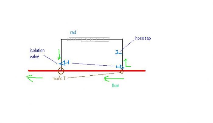

    Here is a basic idea of a possible solution

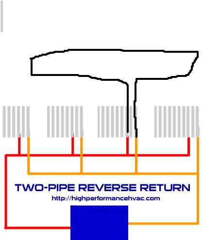

    My system currently has 2 pipes. See attached and here is a explanation I found:
    Two Pipe Direct Return Hydronic Loop
    The Two Pipe Direct Return Loop utilizes more pipe than the one pipe series loop but all radiators and baseboards receive the same temperature of water therefore it is more even heat than in all the radiators and/or baseboards than the one pipe series loop. Another advantage of two pipe direct return loop over the one pipe series loop is that it can be zoned. Zoning gives you more control over where and when you want heat and this can save you money on the cost of heating. As with many hydronic loop systems the two pipe direct return needs balancing valves. The near boiler piping may need to be modified to prevent large delta T between supply and return.

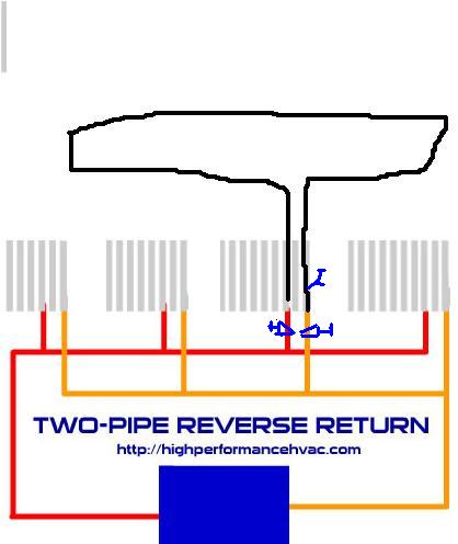

    Additionally I have added an attachment. Please note my modification to the original picture. My modification depicts the fact that all the smaller radiators have a shorter path returning to the boiler therefore receive a greater flow of hot water. The longer baseboard has the greatest internal flow resistance and therefore the least amount of hot water is pumping through it.

    Quote Originally Posted by Anthony Cavlo View Post
    Do you think the force bleed will work better then then adding the monoflow tee?
    Yes, definetly. The same idea will apply to the system that you uploaded. That always get my problem rads to heat up properly.
    2 isolatiion valves with a hose tap in between. They can both be on the return line or the supply line. They do not necessarily need to be on each. You will probably have better control to throttle both valves (ball valves are better to throttle with). Don't forget the hose tap between the 2 valves.
    I don't really think the monoflow T will work in your application without disrupting the rest of the system

    Plumber krow's Avatar
    Feb 2008
    Ontario, Canada
    906
    Below is a scenario of one way the force bleeding can be achieved.
    Just make sure you keep up the pressure up to at least 18 psi as you are bleeding, giving the pressure to work in your advantage.
