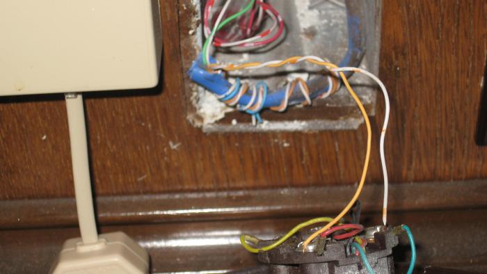

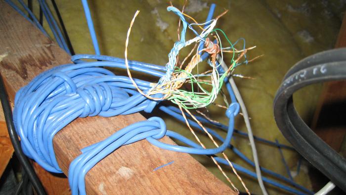

    OK, I moved into this house a couple of years ago. Upon inspecting the attic I was pleased to see what looked like Cat 5 wires running all throughout the attic. Finally, I decided that its a good time to hook up some internet to these bad boys. I will post pictures and ask for advice.

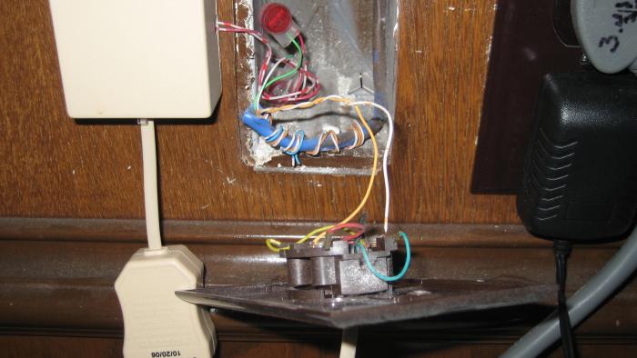

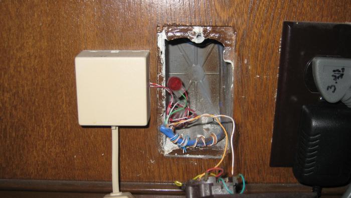

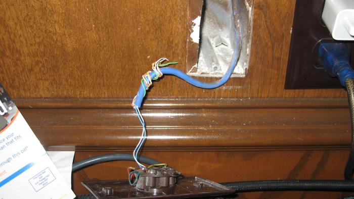

    You can see the spaghetti that is the mix of wire in the attic in one photo. I took my wall plates down in my office to see how they were wired and it looks as if whoever wired the house for phone used what I only assume is Cat 5 cable (house built in 1998).
    1) Can I use these lines to install an access point?
    2) As it gets super hot in that attic during the summer, is it a good idea to put equipment such as modems and routers in the attic?
    I have wireless but it often fails in the far reaches of the house.

    I would suggest cutting off the excess wire in the attic. Get back to before the hideous bends, knots, crimped edges, etc. Cat 5 (and all other high frequency cables) have a minimum turn radius required to protect performance. That first picture of the cat cable violates most any standard or specification above string and fruit juice cans (kitten 0.2).
    The wire from a cat cable must have a limited amount of untwisted wire at the termination. To paraphrase something, "It's the twist stupid". Appears to have been ignored in the photo. Specs are quite clear. If the wire gauge was a bunch larger you could use the wire for low power lighting.
    If you can get back to unmutilated cable, put properly installed connectors on and run wire downstairs somewhere using appropriately installed connectors of the opposite sex. Take these new wires to a switcher/router for proper distribution.
    Based on the work shown, I would be seriously concerned about the treatment of the wires you can't see. New wires are what I would try if it was feasible. Wireless with sufficient relay or range extending devices would probably be a better move. They guy simply had no idea that he was doing.

    From the pictures it looks like you have three phone lines in the house. The pictures show phone jacks wired with the green, orange, and blue pairs. Whoever installed that wire was just using each pair for a different phone line. The rules for phone lines are much more relaxed than if you really need cat 5 standard for computer networking. Unless you plan to stop using your phone jacks or run another cable alongside wherever that one goes, you do not have enough extra pairs to also put an access point or networking on the same cable.
