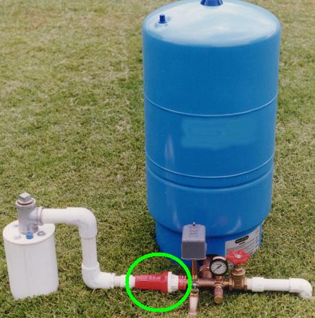

A CSV is very easy to install. It just goes in the water line before the pressure tank or before any water lines tee off.
