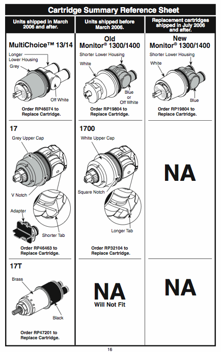

    Double-check the specs, but I think with the 1700, you can use either thermostatic or pressure balance. I personally much prefer thermostatic.
    I was curious as to why the preference. Now that you mention it, lets throw the thermostatic Delta valve into the mix.
    With the R10000 universal valve body. You can put 13/14, 17, or a 17T trim kit on it. What was 1300, 1400, and 1700 they now have an equivalent series 13, 14, and 17. The 17T is the thermostatic version.
    With the newer installation documents they have a chart showing which cartridges fit what.
