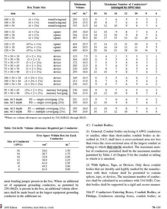

    Quote Originally Posted by Master Brian View Post
    Is this a round box or a square box?
    1) A 4x4x2-1/8 metal box (Round houses 9 conductors) (Square houses 13 conductors). So NO on both counts.
    2) 18. The black and white wires account for 16, the ground wires account for 1. I am also adding 1 for the grounding clamp per 314.15(B)(2) of the NEC dealing with Clamp Fill states internal clamps should account for 1.
    3) 4-11/16 x 2-1/8 square
    First if it is a 4x4 it can't be round now can it?
    Second on the test you will be taking the only correct answer will come from the book not from what we think

    Quote Originally Posted by jwelectric View Post
    Well, the 2008 NEC stated a 4x4 round/octagone box! So, don't ask me, ask whomever wrote the code!
    2nd, I know it isn't what I think. I just said what I would have done previous to reading code, which would have been correct, even though I didn't know the code. I stated that to show that not everyone whom does DIY stuff is an idiot and not all connections done by a DIY'er are incorrect and out of code. Common sense goes a long way!
    So were my answers correct or not?
    My question here is, if the code doesn't list a 4x4 size, they list is as 4 square or 4 round, am I supposed to guess? A 4" dia octagon/round box would still be 4x4 would it not? I would assume 4x4 means square, but I've also taken enough tests to know you don't assume on a test like this! It turns out to be "in material" in this case as there is obiously more conductors than either box will handle....
    You state you are an instructor, I would think you would know better.....
    Here is a screen shot of the 2008 NEC, please show me where they state 4x4 as being square.
    No I suppose that you should take your own advice you mentioned here;
    If something is as long as it is wide or let’s say something was 4x4 then it must be square or at least this is what I was taught in the fifth grade.
    Not
    I think that even a fifth grader would know that anything that was the same on two sides would know that it is a square. I hope that you would know the difference between an octagon and a square. If my third grade math has not left me an octagon has eight sides and would need more numbers than just two. It would look something like this
    As for a round box I think it is pretty easy to recognize as it is a circle.
    One of the hardest things that any instructor has to overcome is the ignorance of the student. When a student thinks they already have the answers to questions it is really hard for the instructor to point anything out.
    As to the NEC stating a box as being a 4x4, the members of the code panels feel that anyone that is messing around with electricity should already know a little something about shapes such as something being a 4x4 would be square.
    Now I am not trying to sound mean or ugly but as you said yourself. “a little common sense goes a long way”
    I think you need to go back and look at a 4" octagon metal box, they aren't shaped as your picture shows. Well, they are an octagon, but the sides aren't equal as your picture shows. So, I can easily see someone just saying 4x4 box, maybe you in your advance state as an instructor would never do that, but others might....
    And it is the ones that would call an octagon or round box a 4x4 that will never get any understanding of box fill.
    I am however glad you finished 5th grade....when you further your education with a college degree and beyond, you'll surely learn not to assume anything!
    Well for what it is worth to you I have a piece of paper with my name on it from North Carolina State University. I don't think I am the one assuming that a 4x4 is a round box now am I?
    Maybe I am wrong, please explain! Afterall you are the teacher, please teach! Was I wrong on what I would have done prior to reading the code?
    That is like asking if there will be a blue truck parked in the store parking lot in the morning on the way to work. No one can say if you would have done something right until after you have done it.
    I am certain, I was correct! If not please enlighten me there as well. 4 wires max wouldn't have been overfill on any 4" box that is 2-1/8" deep.
    This would depend on what you are calling a wire. If you are talking about four #4 conductors then it would not be compliant.
    Crazy part is my common sense tells me, putting much more than that isn't safe, I didn't need to pass any test to tell me that.
    Common sense or not it would not be wrong to install as many as 20 eighteen gauge conductors in that box
    In my opinion taking the home owners test is just passing through the hoops....but if that's what it takes then fine.
    To someone who fully understands the dangers involved with electrical installations it makes perfect sense to test someone on their ability before letting them continue to make electrical installation. To someone who does not fully understand the dangers involved with electricity they just can’t understand why someone should be required to take a test before being allowed to make electrical installations.
    Maybe I didn't read the code correct and that really comes from not wanting to waste a bunch of time flipping through online pages to check on the a couple of things.
    Try as hard as I could I just couldn’t understand what you were saying here. I would suggest that anyone that is going to undertake making an electrical installation read the NEC and study it in detail
    I haven't seen you point anything out, you skirt around acting arrogant, that is it!
    I think you might be a little off base here. You make the comment in your opening post that you have been reading the NEC so every answer I have given you has made reference to that book. I can’t understand why you think that by giving you the code section in question I am not helping you.
    What I have learned in life, is the people whom are the most successful are the ones not whom think they know it all, but the ones that surround themselves with those smarter than they.
    Well my friend I can promise you that this is something I do daily. Just yesterday I was in a meeting with the chair person of code panel 8 and the CEO of the NCAEC as well as others. I do make an effort to ensure that any information I give out is the best.
    I've never claimed to know it all, which is why I am here asking questions! I question why you are here, because all you want to do is mock and act like you know it all, when you clearly don't or you woudn't be here. Some are here to learn, others are here because they truly want to be useful, you seem to be here merely to self promote. Have at it!!
    Spoke in a truly defensive manner. I get this type of statement all the time when I have pointed out to someone where and why they are wrong. There is nothing wrong with making a mistake except the lack in mental ability to accept the fact and admit it, 4x4 and 4 square is the same. It is you who made this statement;
    Now you can try to turn the tables on me all you want but the facts are there in plain sight for the entire world to see. A 4x4 box can not be round plain and simple.
    Is that a fact! You probably asked each and every one of them! I actually don't see the NEC stating a box being 4x4. NEC states it as being 4" square or 4" round/octagonal. You and one other person stated 4x4! NEC, was much more clear....they obviously didn't want confusion....
    If you can’t understand that 4x4 and 4 square is the same then you will not pass that test that someone is going to make you pass so you will look like a pet dog jumping through hoops.
